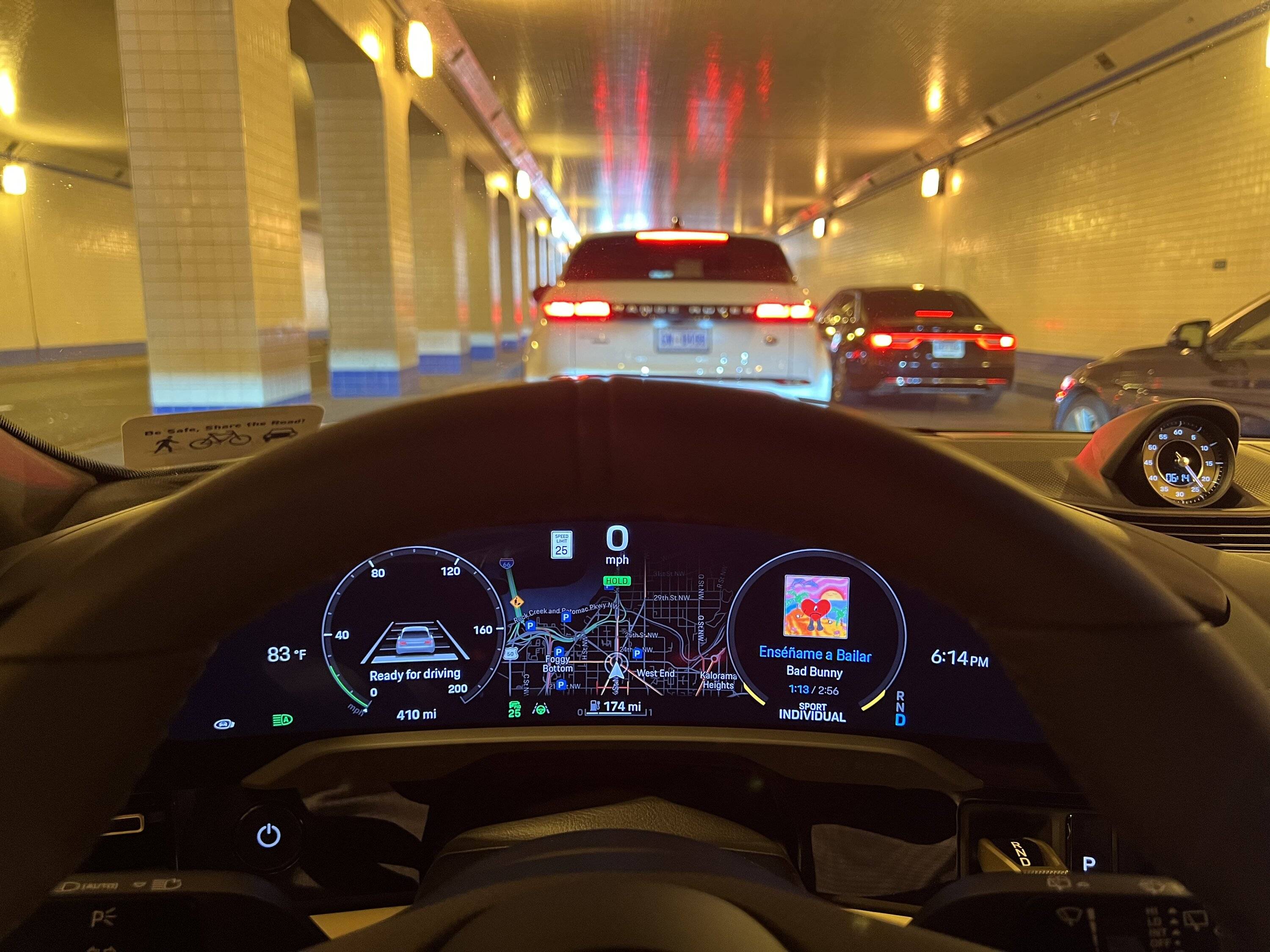

Picture didn’t capture HUD this time, but the busy display shows why I tend to focus on HUD. You can also see how driver assist symbols in green can easily get lost in all of the baubles. I also don't understand why they did not integrate all of the information into the driver's assistance display shown in the left circle. I wish Porsche has a software update suggestion forum that they actually monitored and acted upon.
Porsche Taycan Taycan Options Advice DF0E2696-4CAD-4EFF-A92F-29053EF7FADC
