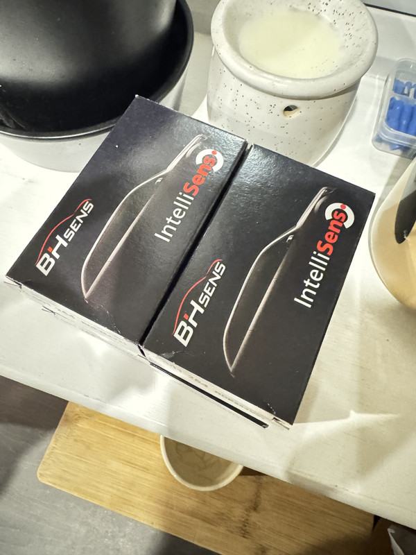

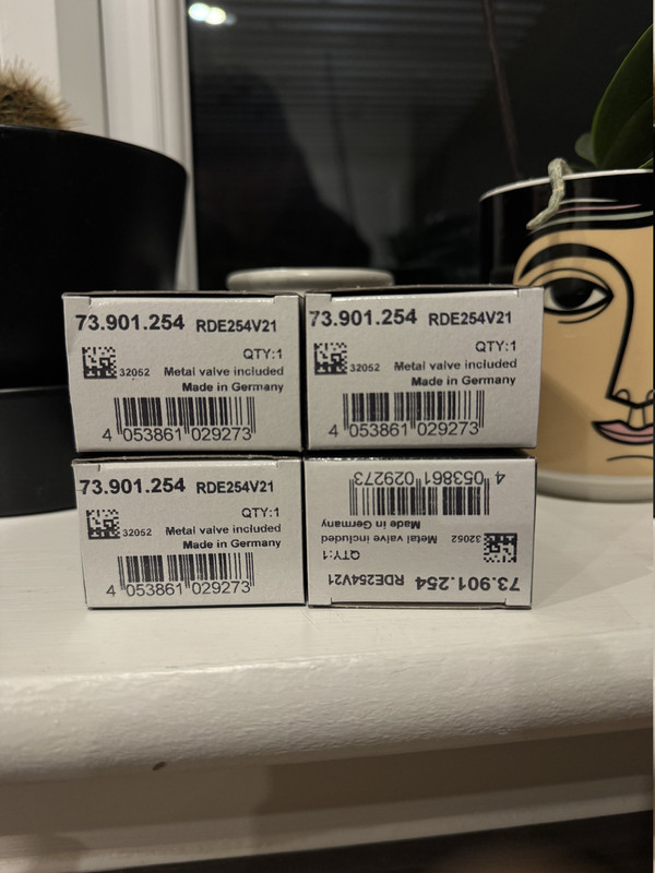

Little bit more digging… this appears to be to be the ideal compromise in terms of price, at 25 quid each I’ll give it a try.
Porsche Taycan Tpms Jen 1 to Jen 1.2 issue IMG-7832
Porsche Taycan Tpms Jen 1 to Jen 1.2 issue IMG-7833

Possibly a stupid question, but how do you fit them? Can they be fitted without removing the tyres from the wheels? Or do you have to remove the tyres, fit the sensors the re-fit the tyres?

Yes, the tyres need to come off.
The original sensors are also made by BH Sens, so you're getting pretty much exactly the same thing. The aftermarket ones can just be programmed to suit a variety of different cars while the original ones have fixed programming.
