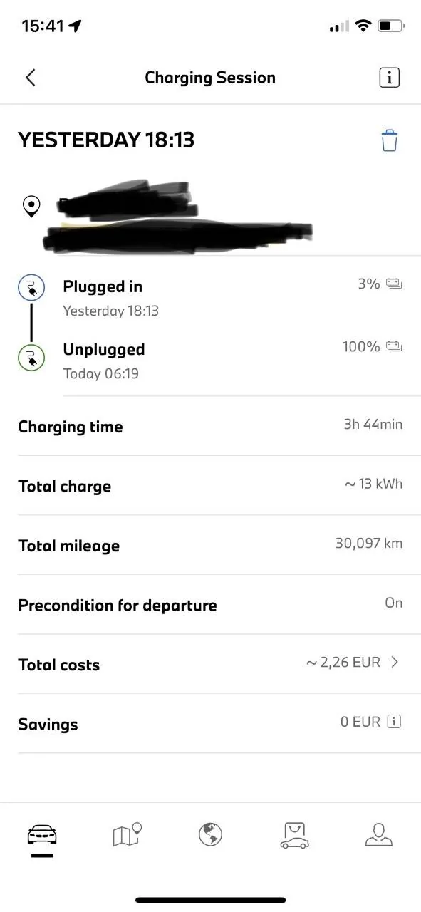

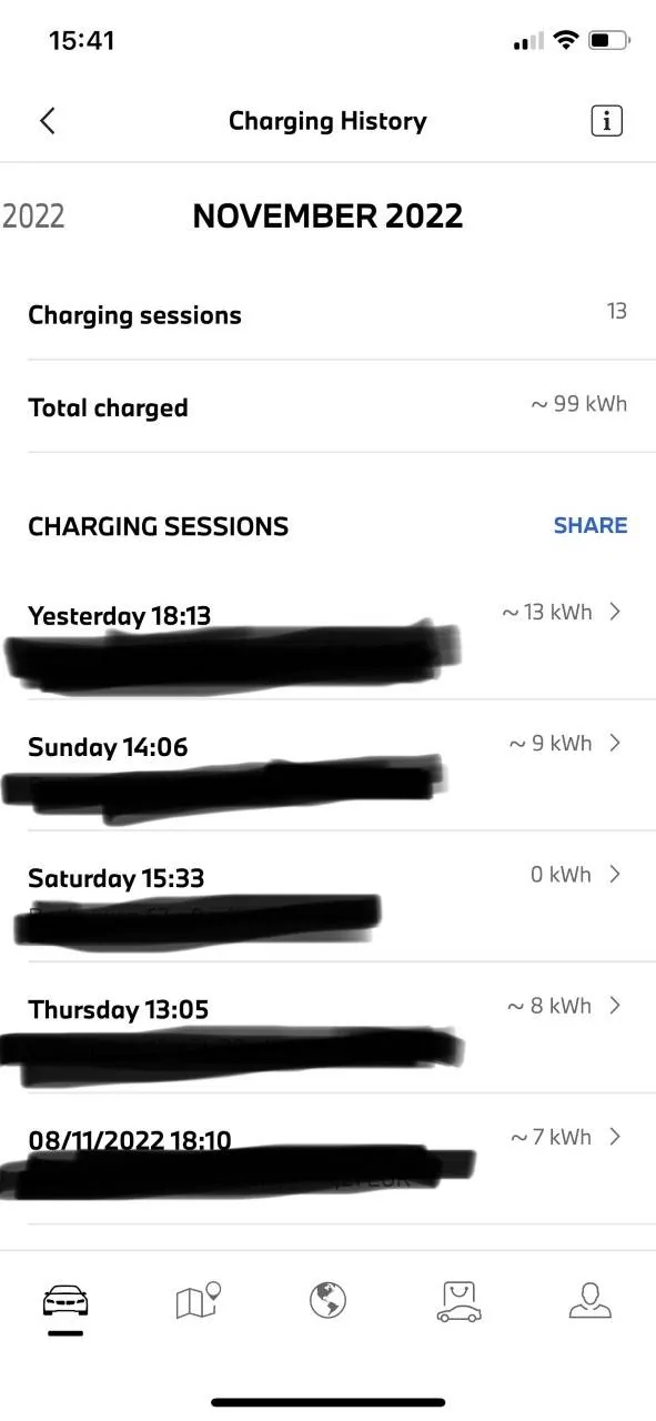

If you are using the Porsche Charging App to activate the EA chargers, you can actually find a history all your charging in there under "Charging history"
I don't see this in my app. That is, somewhere which is labeled "charging history". The closest I see in the app is under "Charging Service", and then "transactions", and indeed it shows my charging transactions as part of the Porsche Charging Service, but there is nowhere in the app where it shows other charging sessions, such as at home, where I didn't use Porsche Charging Service. It would be nice if I could see that. I can certainly see every charging sessions for my BMW, whether it was using the BMW Charging account or not, and it shows me the start and end time, what the SoC was at the start and end, and also how many kWh were taken.
3,155
2,747
Unfortunately it is not the Taycan that is reporting the charging session, it is the charger. In the Porsche charging service you will see the Ionity or other stations report. The invoice details will also show exact amount of energy. At home you can achieve the same with the Porsche PMCC EVSE, but not with say a Tesla Wall Charger.
I guess by your description above your BMW is reporting the charging session and the you will get that as a summary. But that is not how Porsche do this?
Throb
Apr 30, 2022
433
565
NL & UK
Yes. The BMW app shows data from the car and not just the data from the charging service. Below you can see the overall summary, and then you can click on a particular session to see more detail, such as SoC at the start and end, etc.
