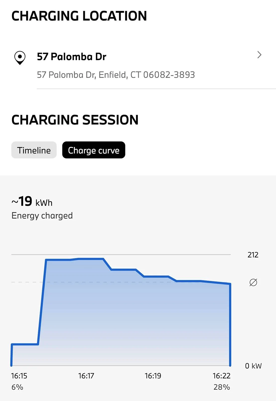

Meanwhile, here is my wife with her i4 at a Magic Dock right now.
Maxed out the charging curve despite air temps in the 30sF. And despite no battery preconditioning. And despite driving only a short distance from her prior stop.
So both the battery and the charger were quite cold.
Just amazing how bad the CCS1 scene is here by comparison.

I didn’t specify what time period!

The i4 definitely has a preconditioning feature, accessed via either selecting an officially designed DCFC station in the car nav app or by pressing an icon in the car charging app.
But even without that, got up to speed almost immediately at the Magic Dock.

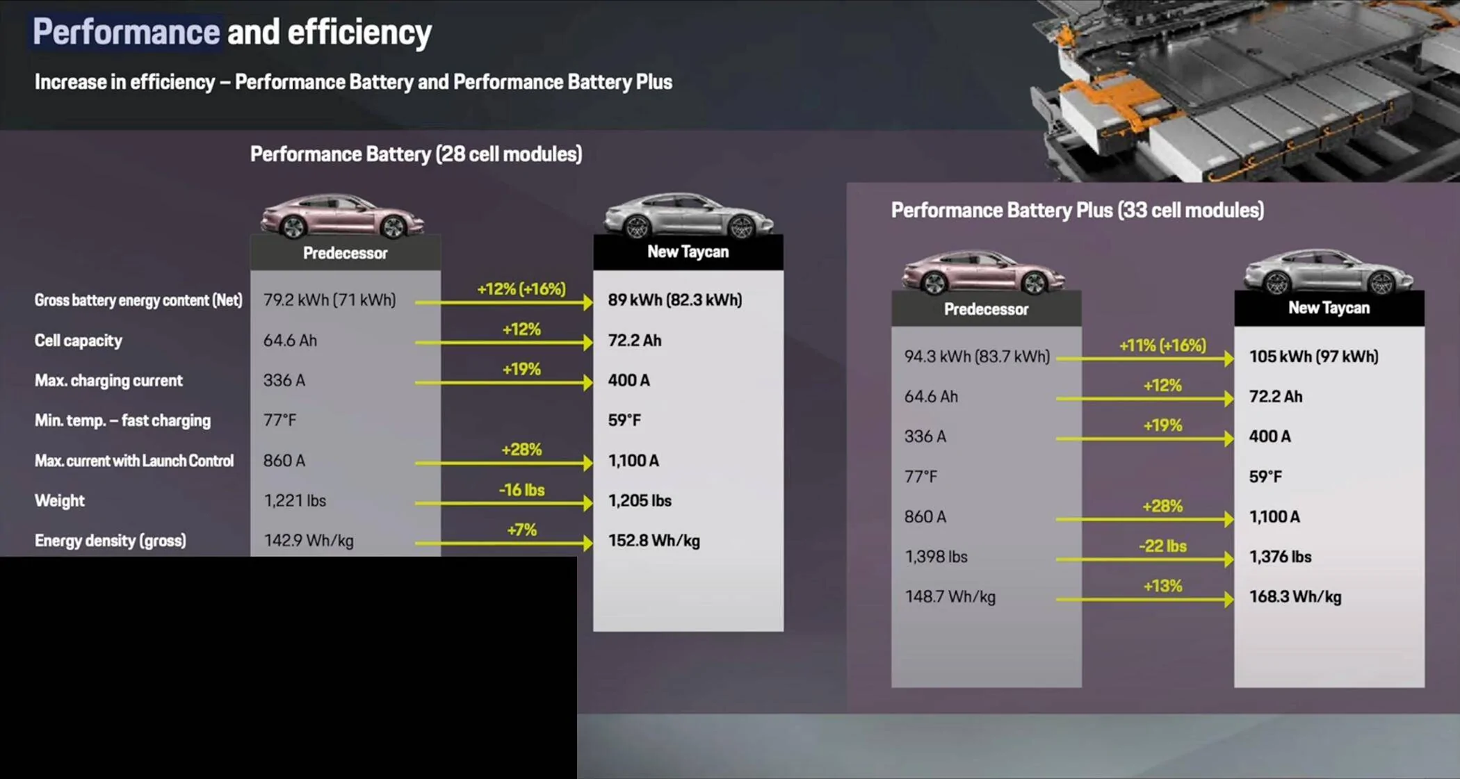

Yeah, lets hope they stay fixed!
That Manchester charge was with preconditioned battery at ~100F.
For comparison, February 23rd last year at 63F only got ~50kW because it was under the 77F DC charge minimum.
Seabrook February 25th last year at 68F (45F when set destination 25 minutes before) ramped up to ~100kW, settled at -85kW, at 80% down to 80kW, at 85% down to 75kW.

The 77F DC charge minimum?
I doubt my wife’s i4 battery was even at 60F when she started charging yesterday with air temps in the 30sF yet the Magic Dock quickly delivered at 212F.

What is meant by "minimum" in this context?
My understanding is that, all else being equal, charging speed is a function of battery temperature, with the max charging curve attainable only over some range of optimal temperatures.
But DCFC can certainly occur far below that cited 77F current min.

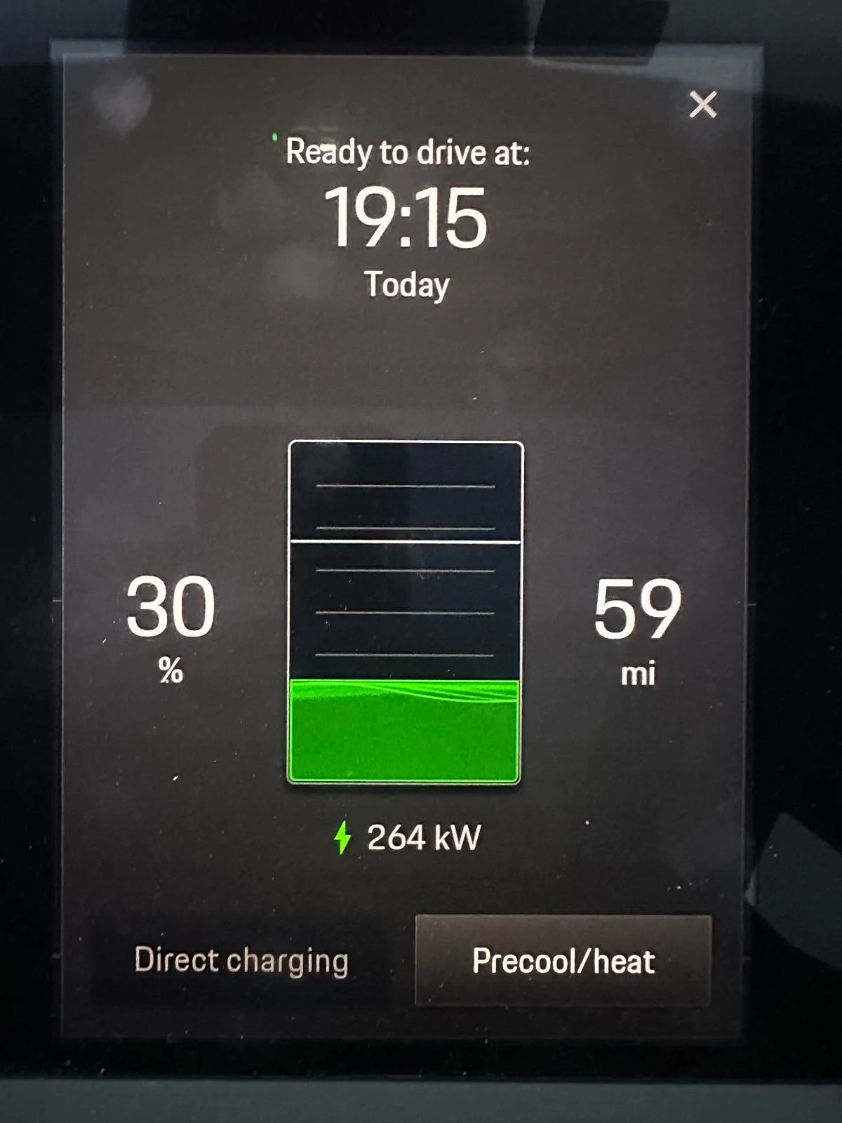

So after all that I just stopped to charge at a EA 350kw charger in Lee, MA - the battery was pre heated to 116.F thanks to the planner and right of the bat I got 264kw sustained from 20% to about 35%. After that it slowed as expected but held 188k till 60%. Glad to see nothing is wrong with the car!
