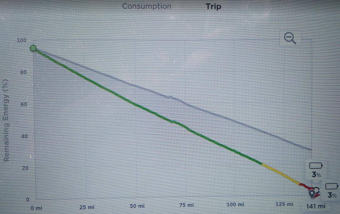

Porsche Taycan Battery capacity and range estimates 1704370892724

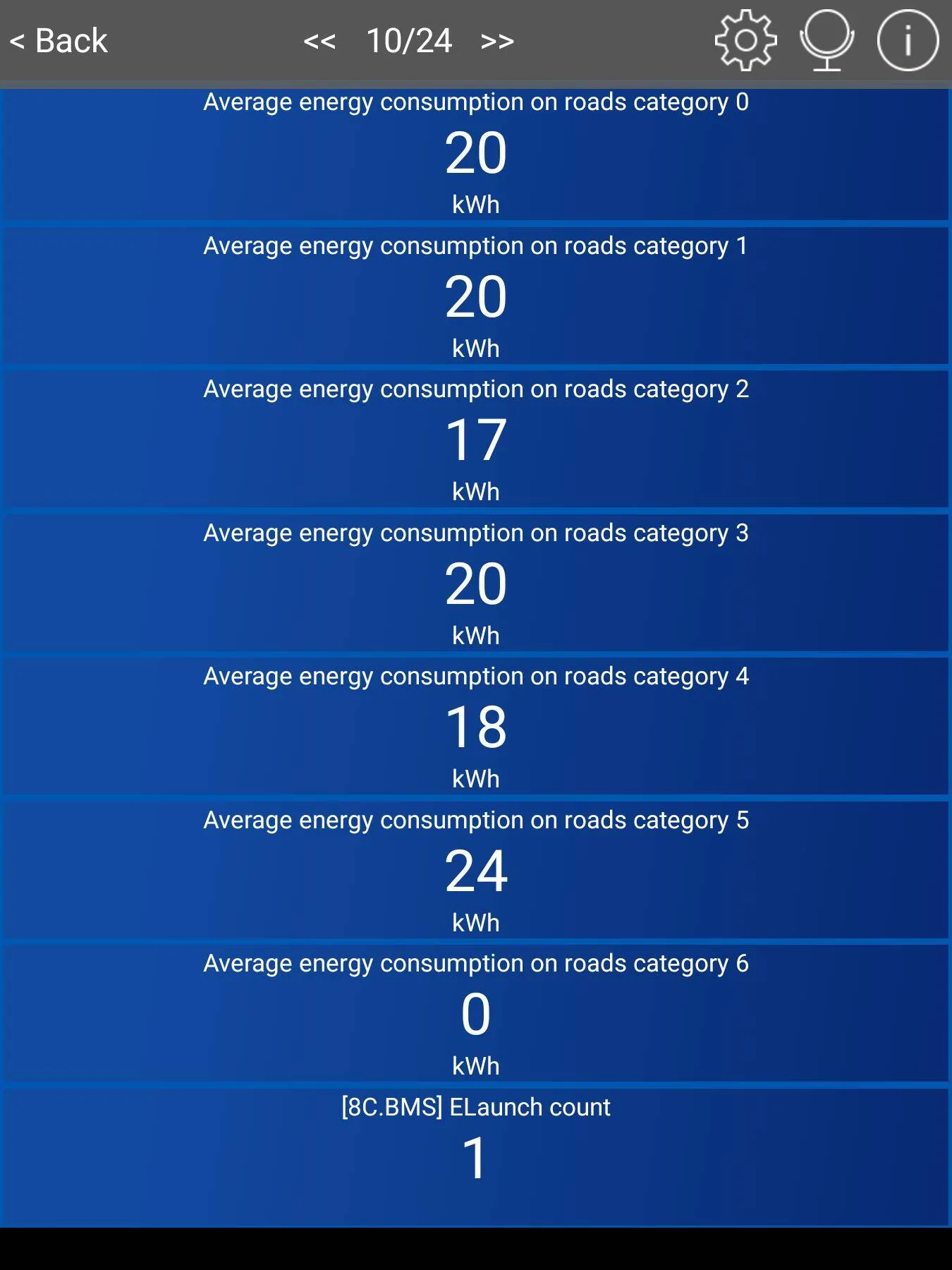

Something I noticed last night while getting stats on the car before it charged was this page in the car scanner app dashboard.
Porsche Taycan Battery capacity and range estimates 1704384625848
I'm guessing this is part of what the car uses for range estimation and why it's so accurate. I infer that each category corresponds to a speed taken from the Nav system's maps or the camera that reads posted speed limits.
When I looked at this page earlier with only a few hundred miles on the car, some of the intermediate road categories read 0 as well as category 6. Category 5 would likely correspond to roads with speed limits of 70 MPH because that's highest posted limit for any roads are here in Minnesota. Category 6 likely starts somewhere above that speed.
If that's the case estimating consumption for a trip is a matter of taking the distance to be traveled on each part of the trip on a particular category times the average consumption for the category.
