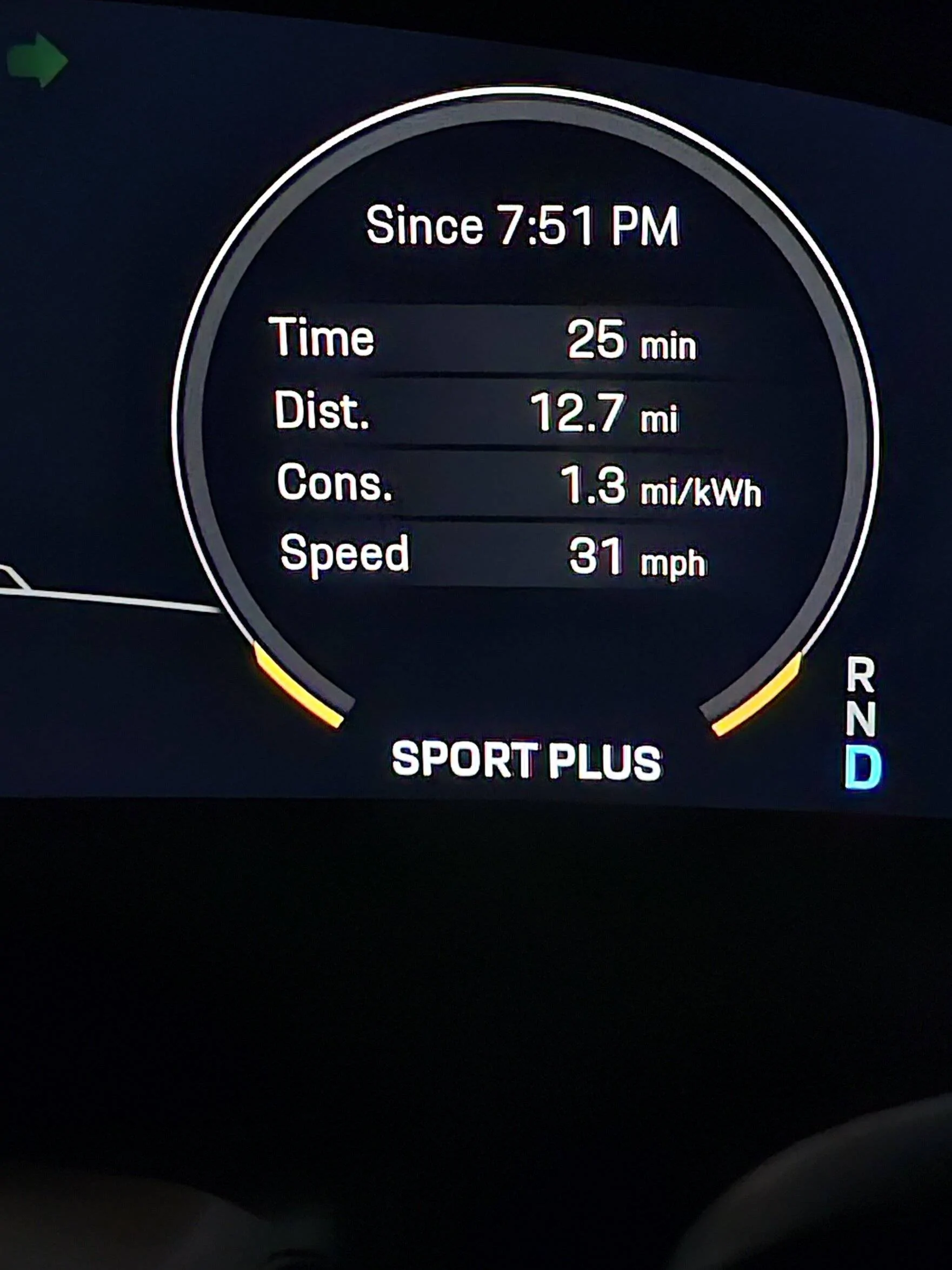

Andy,
thanks for the info on the 3rd tube. Tried it this morning and yes, it's a good way to see the power being used. I never use the 'trip' setting on the 3rd tube as its usually showing the 'info' stuff. I will do more now.

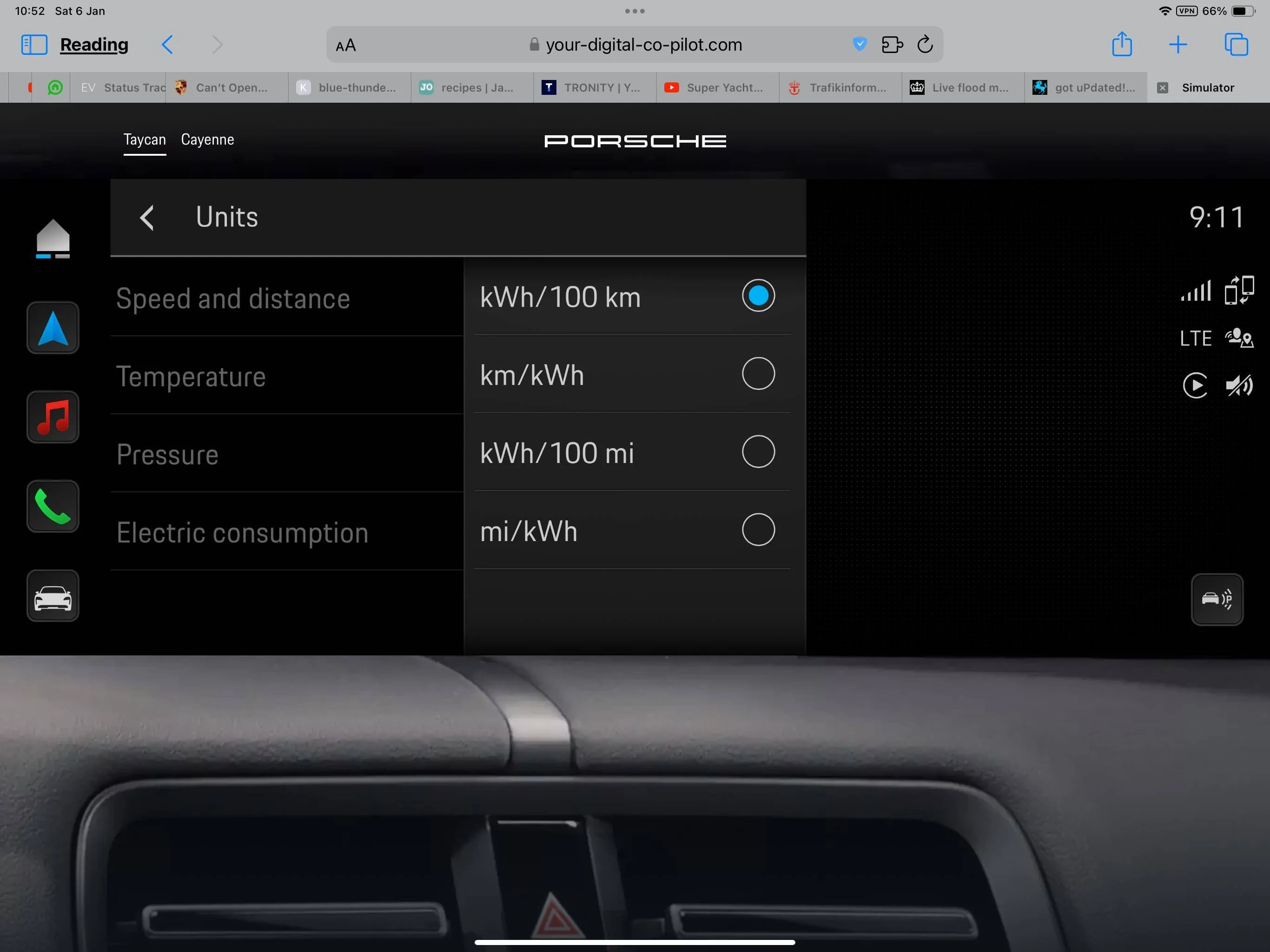

Question: how do you get the Cons line (the important one) showing m/kWh rather than what mine is showing me ie kWh/100mile?
Wow, it must have been cold!!! Only 1.3 kWh per mile.......but that's exactly what I find. I do circa 12-15 300+ mile trips a year but the rest is often short trips locally so you use 10% of the battery just heating up the car in the winter and you get a range of less than 100 miles for the 'normal' charge window.

Andy,
In the general settings for the car there's a "units" section (miles/km psi/bar etc) and consumption is in there iirc.
The "info" tube can be configured in general settings too. You can select what each of the 4 (maybe 5) lines show. And there may be options there to do what you need.
I've sent feedback to Porsche on this sort of thing. The system is needlessly restrictive. Why limit what each tube can display? It must have been harder to do this than allow anything goes (if I want "media" in all three tubes, why should Porsche care?).
Ref my trip... It was around 6degC iirc but very wet and windy and the car had been stood outside for 10hrs or so. Consumption improves rapidly on that display as miles are covered....
The car's overall average across 14.5k miles is 27mi/kWh, but my average since buying it (4.5k miles ago) is low 2s.

You can easily set the different units in the PCM. This is a screenshot from my sofa of the PCM simulator.
Porsche Taycan Battery capacity and range estimates IMG_1884
