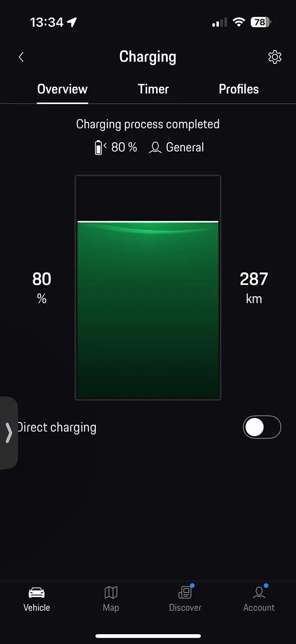

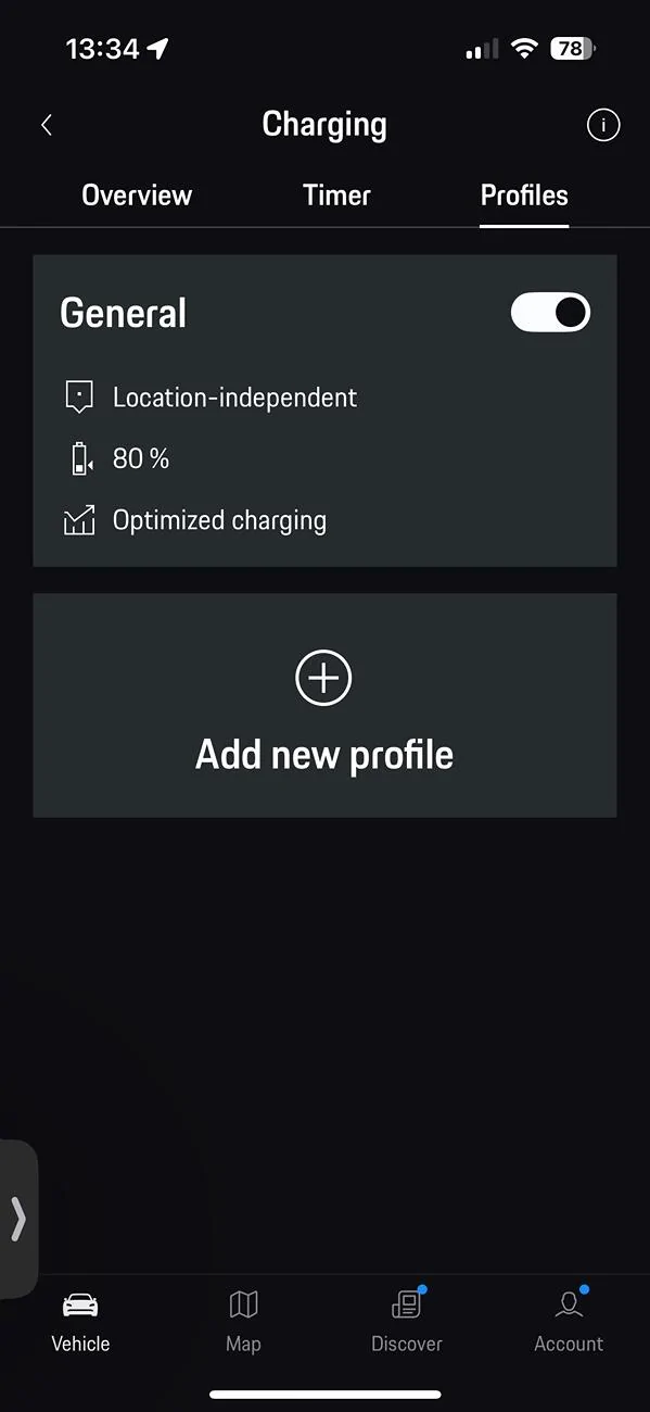

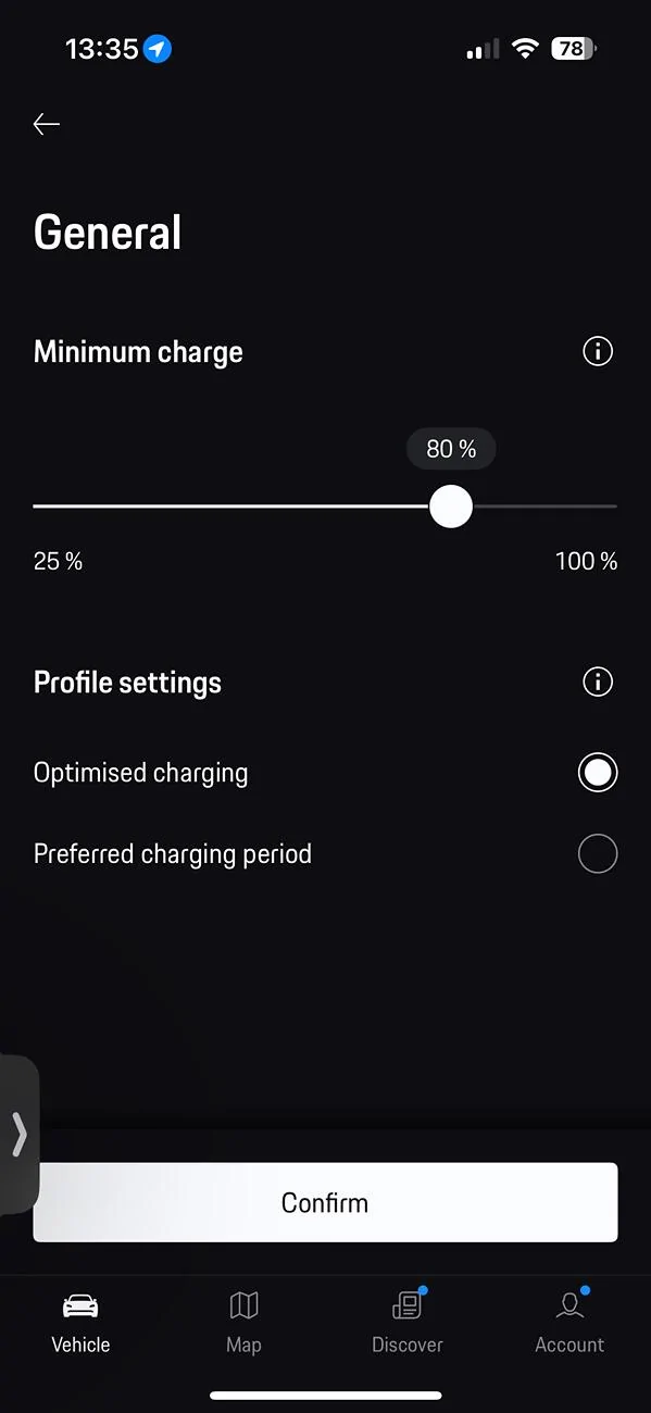

Yes. Have only ever had one profile and it always overshoots the 85% when this is set.
I’m certain that it didn’t used to be this way. Last year it used to stop at 85% but these days it just keeps going (I had the latest software update with the breaks recall a couple of months ago and it may even have changed since that)

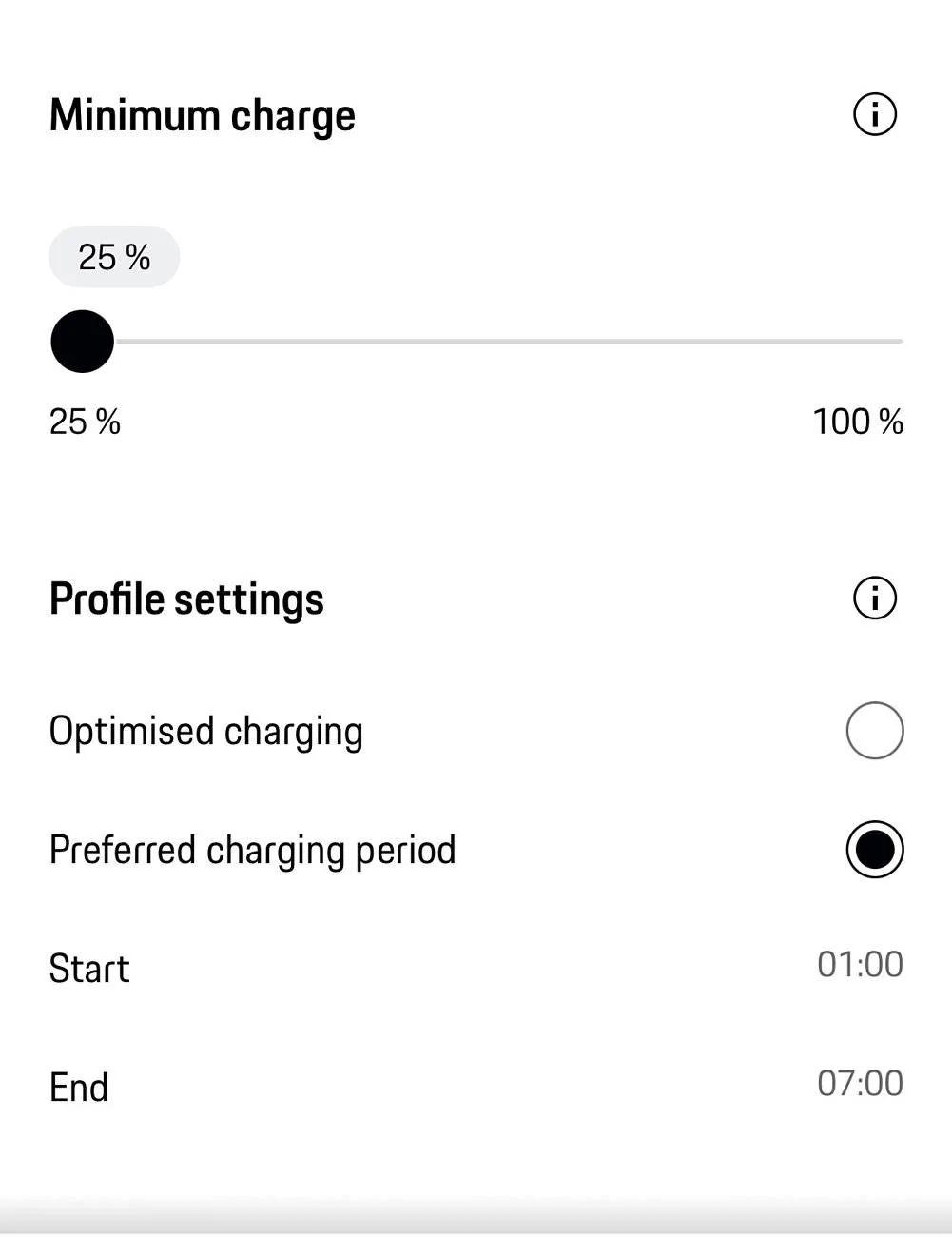

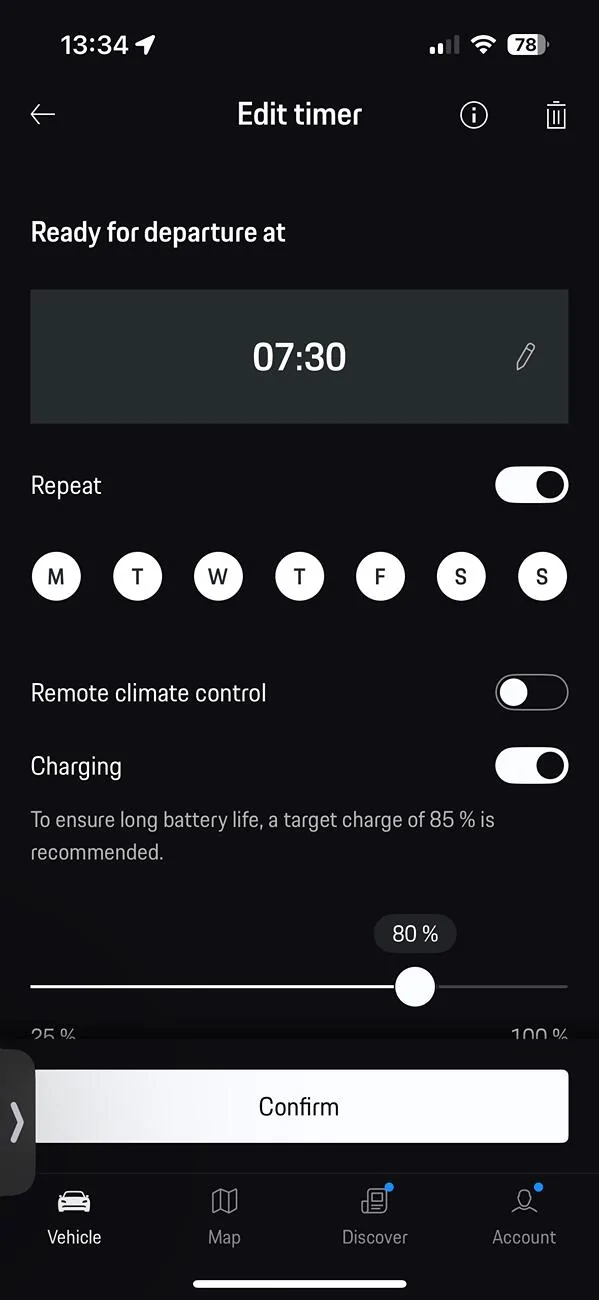

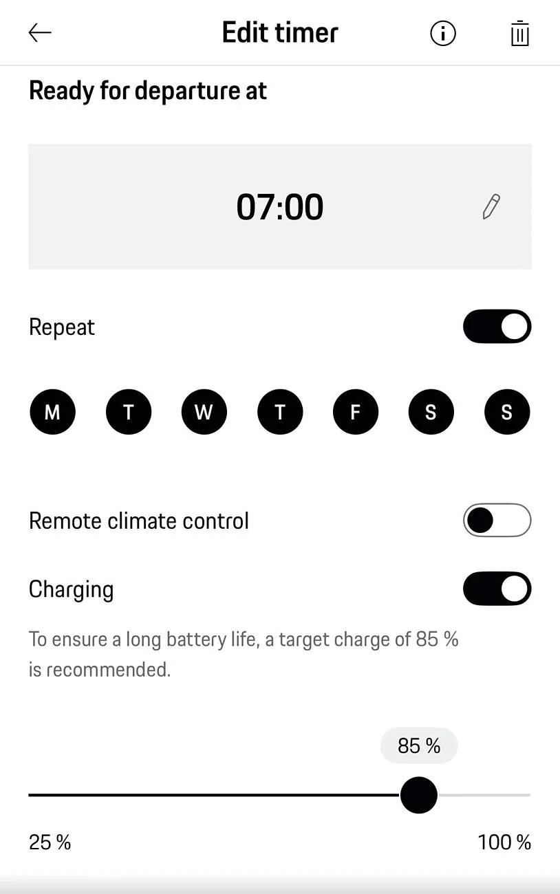

Apologies in advance if you’ve already discounted this.
The following are my current settings for charging - Profile and Timer. I’ve been using this since the car was delivered and it charges to 85% by 0700 each day:
Porsche Taycan Charge to 85% - What on earth is going on!!! IMG_2553
Porsche Taycan Charge to 85% - What on earth is going on!!! IMG_2554
This has worked for almost two years of ownership. If the above settings are the same for you, all I can suggest is a trip to the dealership to see why it isn’t working? Most likely they will probably be stumped as well but it will, at least, get escalated on your behalf to Stuttgart.

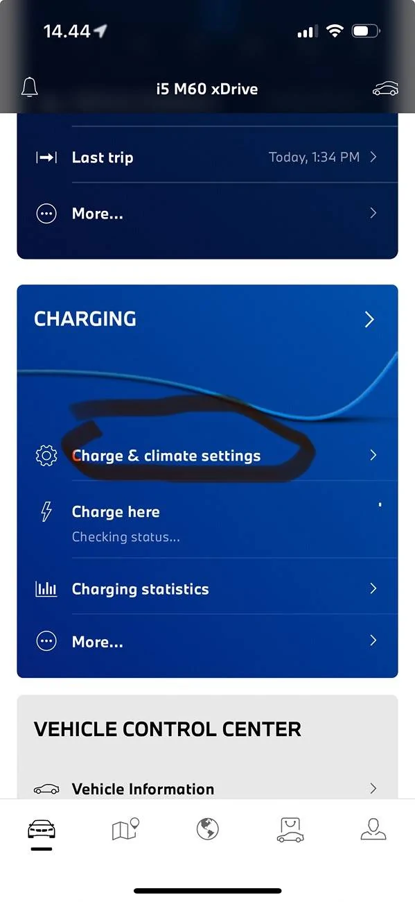

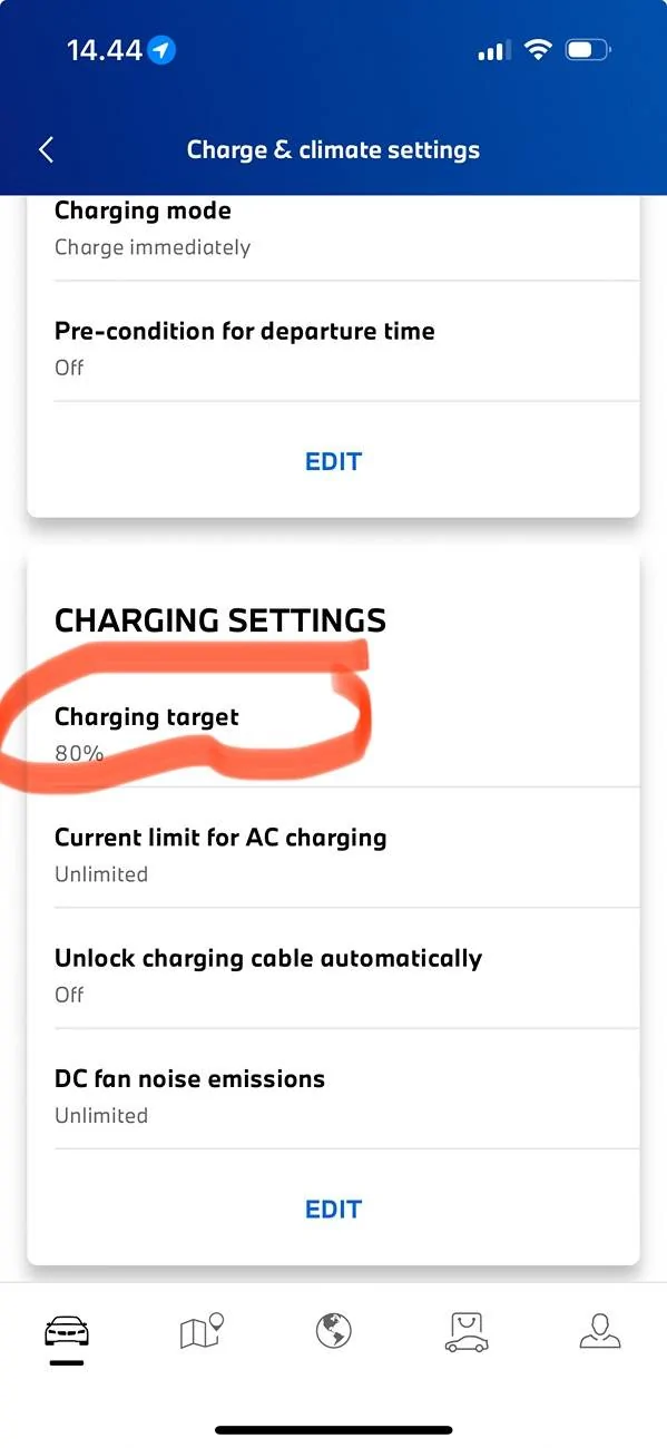

It has been 5 f***ing years this car is on the market… and still the same questions. Porsche, do something about this sh8t. We’re tired.
Here is a hint to Porsche in case if they can’t access other manufacturers’ solutions
Porsche Taycan Charge to 85% - What on earth is going on!!! IMG_5324
Porsche Taycan Charge to 85% - What on earth is going on!!! IMG_5323

Also, is the one and only profile you have, somehow set to a geo-location? If so, disable the location based.

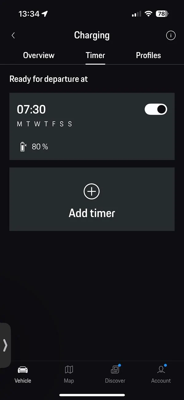

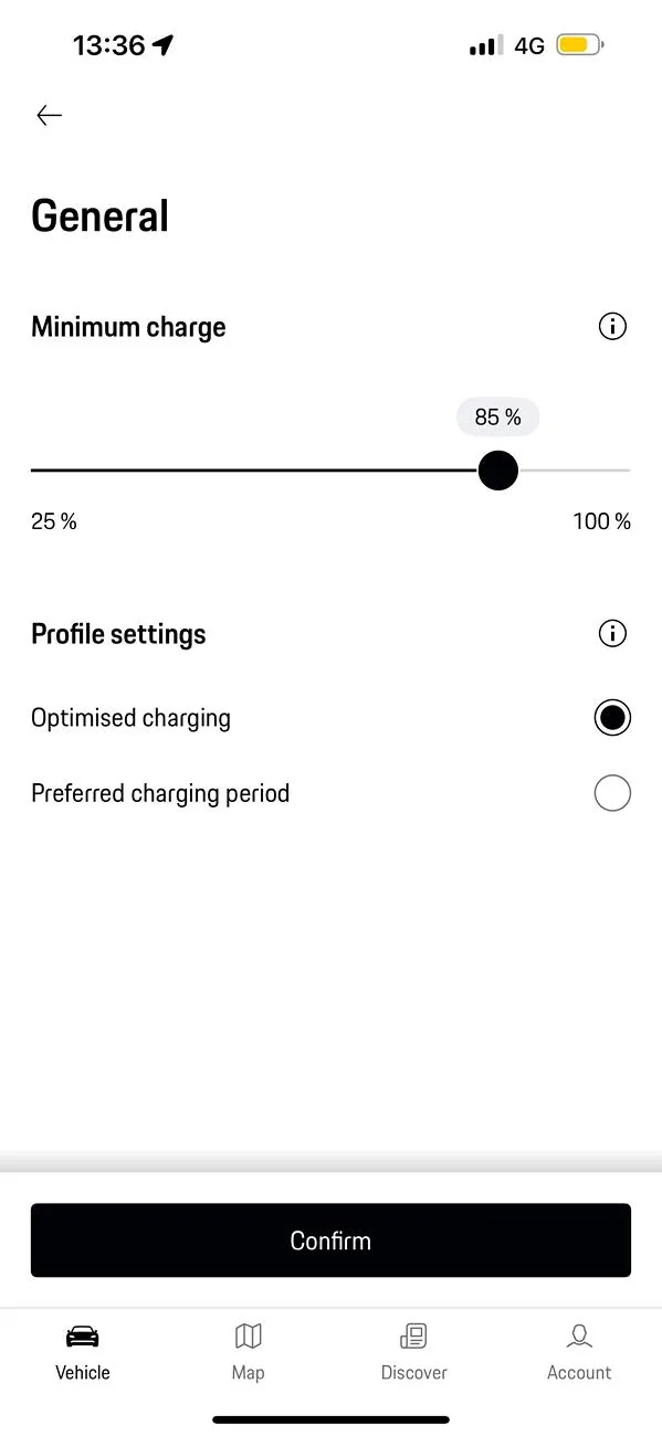

Yes, it always charges past and no, it’s not location specific. See attached.
the more I think about it the more I think it stopped working after the recall software update it had about a month ago
Porsche Taycan Charge to 85% - What on earth is going on!!! IMG_0586
