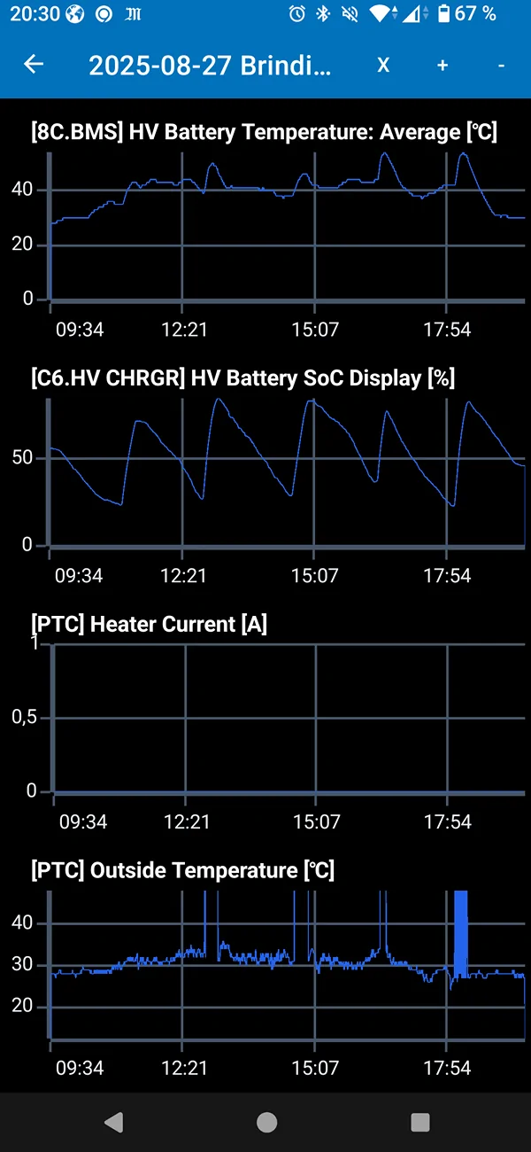

I'll give two examples where I was driven in Range mode.
-summer: outside temp around 30°C, 5 stops, heater never started once. Battery temp. slowly increases to 35° while driving, and stays between 40° and 50° after the first charge. I do not rule out however that BMS might have decreased the cooling of the battery when getting close to the first charger.

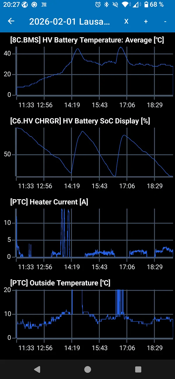

- winter: a recent trip where the NAV crashes perhaps 10 times (or more...). it was not extremely cold (outside temp. between 5 to 10°). Only 2 stops that time. Heater was on to heat inside (2 to 3 A), and on for preconditioning for the first stop. Battery temp. stayed around 30° after the 1st stop, and there was no need to heat it for the 2nd stop.
Porsche Taycan EU/UK: Ongoing navigation issues [Solved with PCM v3892] Screenshot_20260218-202726
I have other datasets where I deliberately did not use the NAV planner under similar temp. Battery was around 25° at 1st stop, max charging speed did not exceed 150kW. It took about 10 more mins to charge to 85% compared to with preconditioning. Not a big deal on a 7hrs trip.

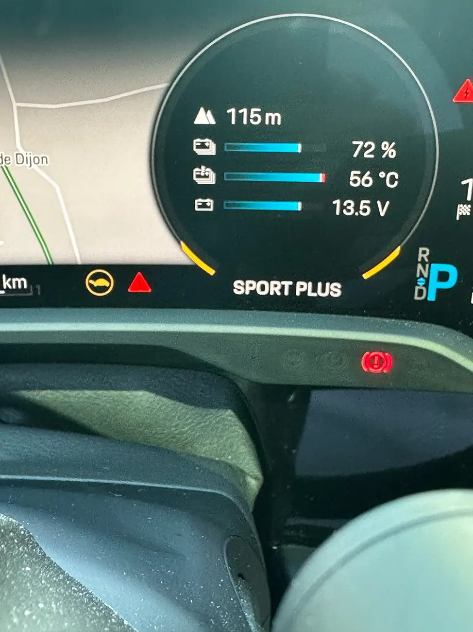

How can you check if pre conditioning is still on?
I have had the battery heater on for quite long drives. The battery temperature was very high and did not cool down. CarScanner showed that the PTC heater continued wit some very high amps. Much more amps than cabin heater ever has consumed, even in minus 20C in Norway.
Needless to say the trip consumption was very high.
I tried to put the car in sport plus to cool down the battery, but no help at all.

something similar happened in the winter trip I mention above.
I split the phone screen with Waze and Car scanner when driving.
NAV crashed when I was getting close to the first stop, while heater was on preconditioning (>10A). I then noticed that the heater was still on for about a minute, while I was resetting the whole thing and was a bit surprised since the car had (I assume) no destination defined. But it stopped after that minute (or about) and started again when NAV calculated the charging stops.
in your case, it didn't stop for some reason. Did you re-enter the destination or perhaps gave up (and a flag somewhere wasn't reset) ?

In my case when it happened, only turning off and on the car stopped the “pre-conditioning”/heating.
New destination/route did not fix it.
Sport plus did however kick in the fans for me, which did help cool down the battery fast after the car restart; so it could be that your fans are broken @Scandinavian
