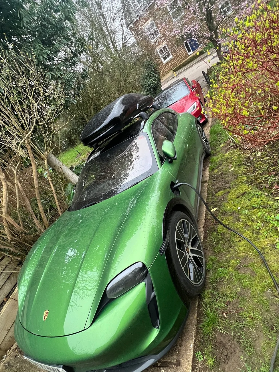

Good question. Luckily the new CEO of Porsche is an old colleague.
Given I dumped the Taycan for the 8yo Model S for the Swiss ski trip last week, I shall be forwarding him a link to this thread and asking him this very question.
I'd rather never recieve another copy of Christophorus EVER but get better actual consumer information from Porsche AG mothership about my car and what they doing to fix its problems.
See photo, Taycan all dressed up and then left at home.
Tesla navigation completed 1500 miles and 10 charges there and back without a single glitch whereas Porsche crashes every ten minutes. AND I don't have to pay Porsche connected services £20 a month for it!
Let's see what he says.
