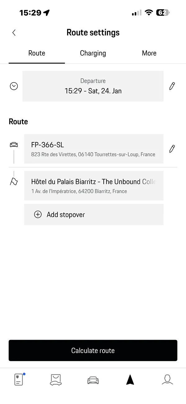

First choose your destination!
Porsche Taycan EU/UK: Ongoing navigation issues IMG_3379
Very nice hotel by the way!

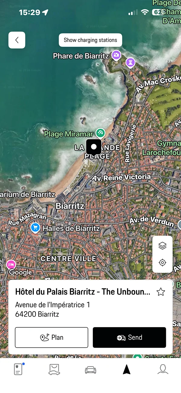

Then look for the Charging in this picture

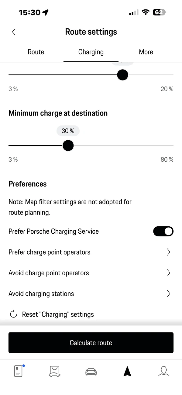

Porsche Taycan EU/UK: Ongoing navigation issues IMG_3380
Then set your desired SoCat charging stops as well as at the destination and find the prefer chrhe point operators.

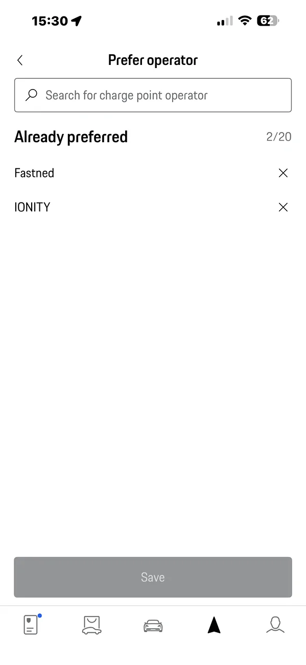

Porsche Taycan EU/UK: Ongoing navigation issues IMG_3381
Then just select the operators you would like to use!
Porsche Taycan EU/UK: Ongoing navigation issues IMG_3382
Beats me though that you have to do it in such a cumbersome way.
Why oh why have they not got that filter available in the car directly.

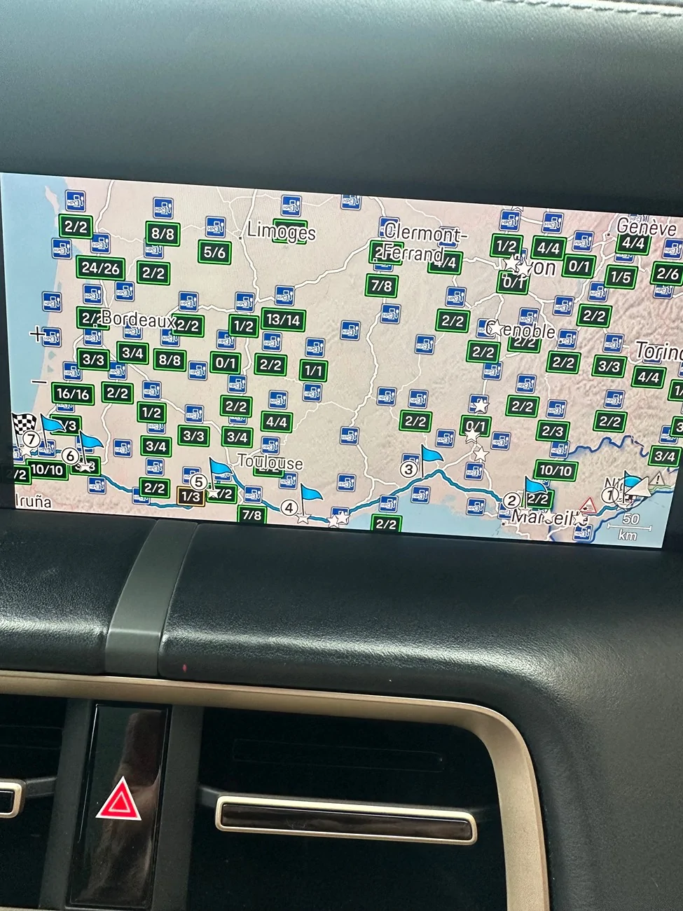

If you look at the screen shot below you can see the absolute clutter of charger information, while navigating to the west coast of France. No wonder it is suspected that the PCM will run out of memory, by displaying all these charger details. I can understand that information for possible charging stops along the route can be of value. But to display chargers way back at 180 degrees of intended travel seems unnecessary. I did not scroll around the map too much to check if the same information would be displayed for all chargers in all of Europe. My filter is set to only use chargers > 150 kW. Most of the information is also way out of the range in my car, indicated by the thin blue line.
Porsche Taycan EU/UK: Ongoing navigation issues IMG_3376
Let’s see how long time it takes before the navigation crashes again.
The design dates back to an era where you had to search hi and lo to find a HPC. In our present time, it makes zero sense to show charge points away from your route when you are spoiled for choice along that route.
I missed another trick. Where do I specify that, please? (I have a hazy memory of seeing 50 somewhere, but I cannot readily recall. And in spite of this setting, my display will also happily show 7kW AC chargers when zooming in.) I would try 300kW as a starting value because those things rarely dispense more than 150 anyway.
