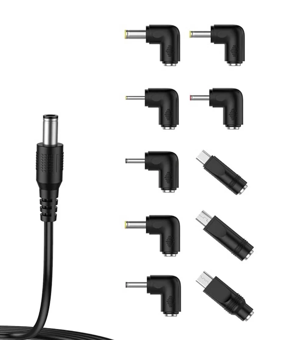

What’s a standard dashcam connector? 12V cigarette lighter one?
Something that can be fitted to a variety of low voltage connectors. It could simply terminate in MicroUSB or look something like this:

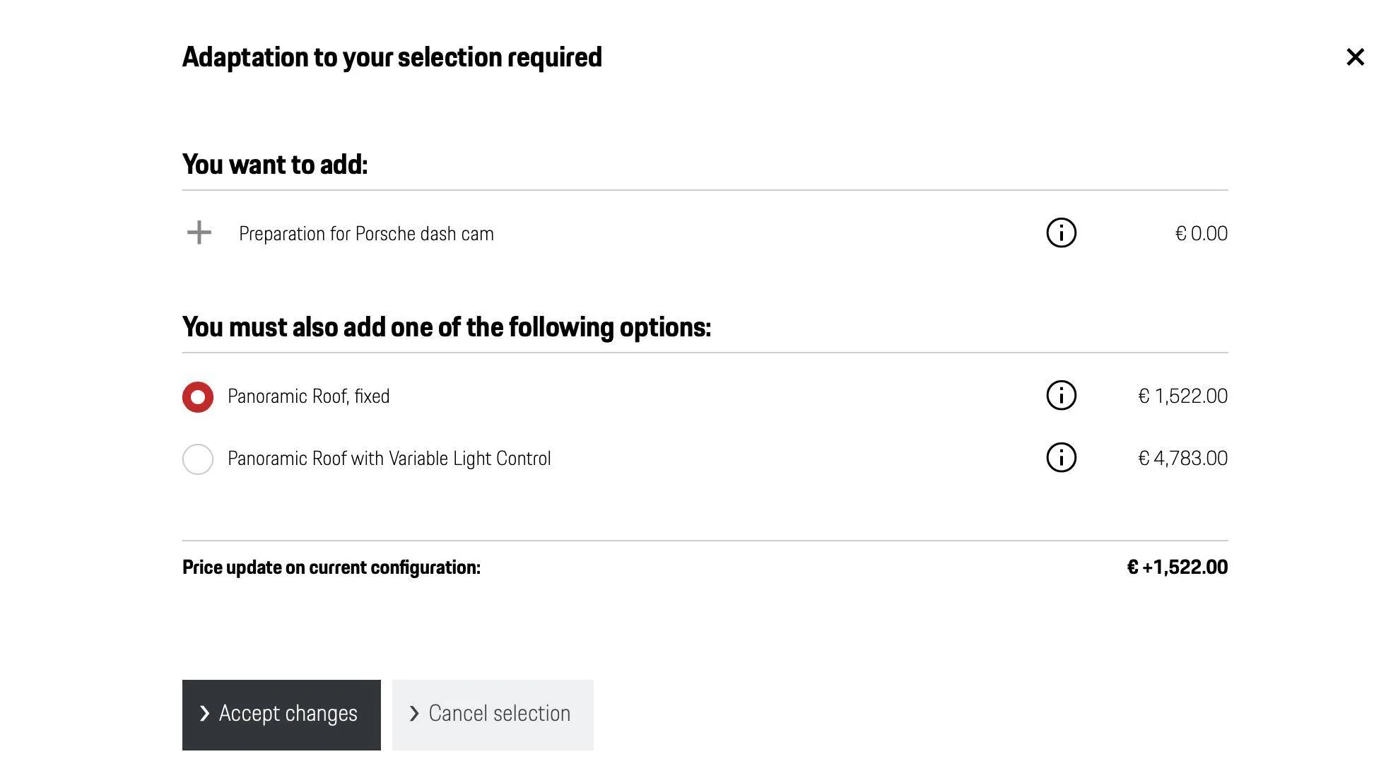

Interestingly – at least on the Irish configurator – choosing pre-wiring forces you to take a panoramic roof option:
Porsche Taycan Front and rear dashcam preparation option Screenshot 2022-11-27 at 02.19.17
An issue for those of us who dislike the glass roof.
Doesn’t appear to be the case in the UK configurator. I wonder why the Irish one is linking the two together?

I could not add it to my RWD order without added a glass roof that I absolutely don’t want. Maybe the glass roof is require if it’s a saloon?
Good spot. When I looked on the configurator, I was checking a CT4S which didn’t add the requirement. I wonder why there’s difference between the saloon and the CT?
I would not call those standard dashcam plugs since the dashcams don't come with cable that would connect to it. Most dashcams come with an open wire to tie to anything you want and sometimes a 12V cigarette lighter cable. As long as the pre-wire has 12V wired to any type connector, you can always tap it. Personally I hope it's both switched and unswitched 12V wired up there.

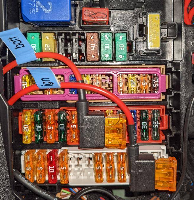

all discussed previously including the warranty question. No magic. Easy to run power up the A-pillar from the driver's (US) side footwell fusebox, creating a separate circuit to power the dashcam:
https://www.taycanforum.com/forum/threads/dashcam-in-a-taycan.9286/page-2#post-148357
If you want to get fancy with a Blackvue or similar that has a standby "parking mode" with constant on (batt) and ignition only on power (ign):
Porsche Taycan Front and rear dashcam preparation option FuseTaps
