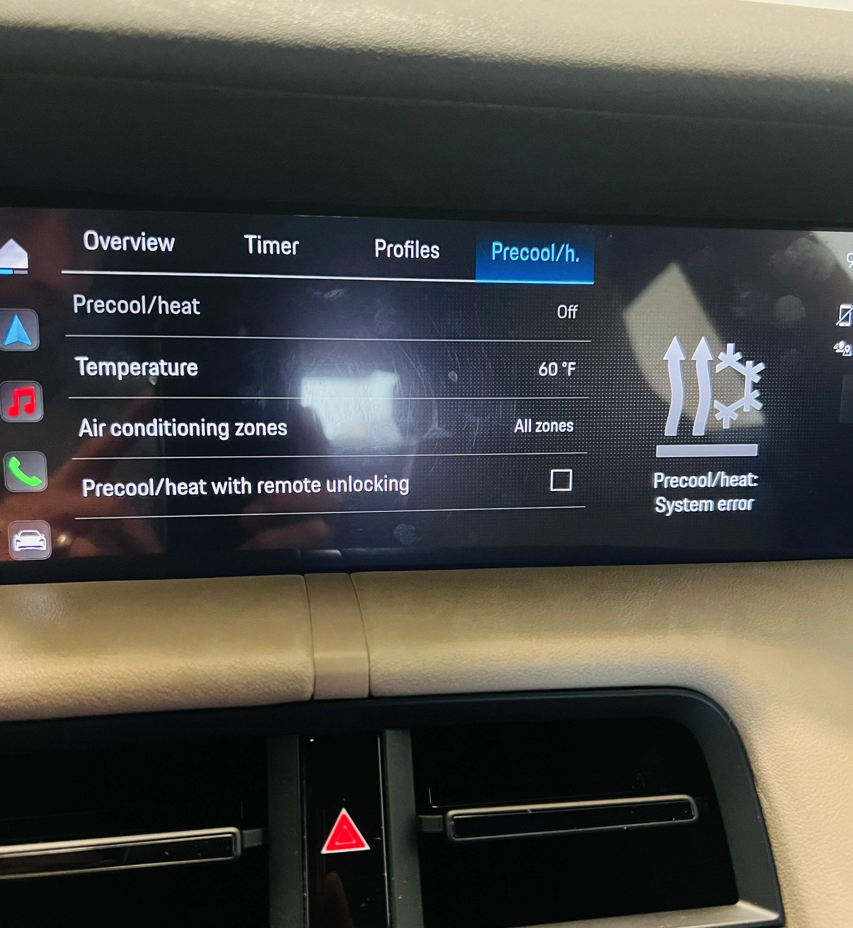

I think I'm unfortunately late to this party. 2022 RWD now with 18K miles but heater/remote heating not working for a week now. AC works fine and car works fine. Can anyone confirm if the error in this pic means that I've joined the heater failure club? I'm due for my 2 year service soon anyway. 2 for 1. I still love this car.

I think I'm unfortunately late to this party. 2022 RWD now with 18K miles but heater/remote heating not working for a week now. AC works fine and car works fine. Can anyway confirm if the error in this pic means that I've joined the heater failure club? I'm due for my 2 year service soon anyway. 2 for 1. I still love this car.
Congrats. You are in the failed heater club.
Get your club badge from @whitex.

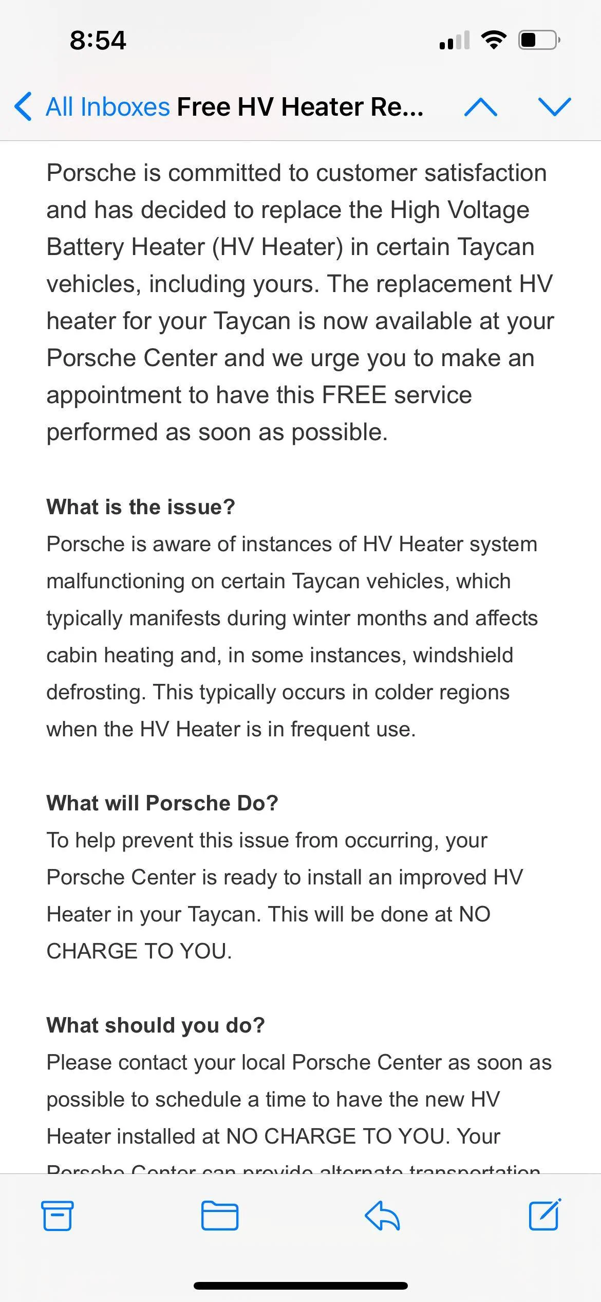

2022 RWD at 18k, heater failed last week, and just got this email today. Good times. Still love this car. Seriously.
Since the email says your replacement heater is available, hopefully the dealer won't tell you need to a wait a while to get the part.
So basically Porsche is saying that any Taycan that uses the heater ‘frequently’ in cold weather is highly likely to have it fail I.e. we all have a faulty part that will ultimately fail but for those of us in climates with less freq use chances are it will fail out of warranty - that is seriously bogus to me. If a fundamentally flawed piece of equipment was installed in our cars from the factory, there should be a universal replacement campaign - period.
