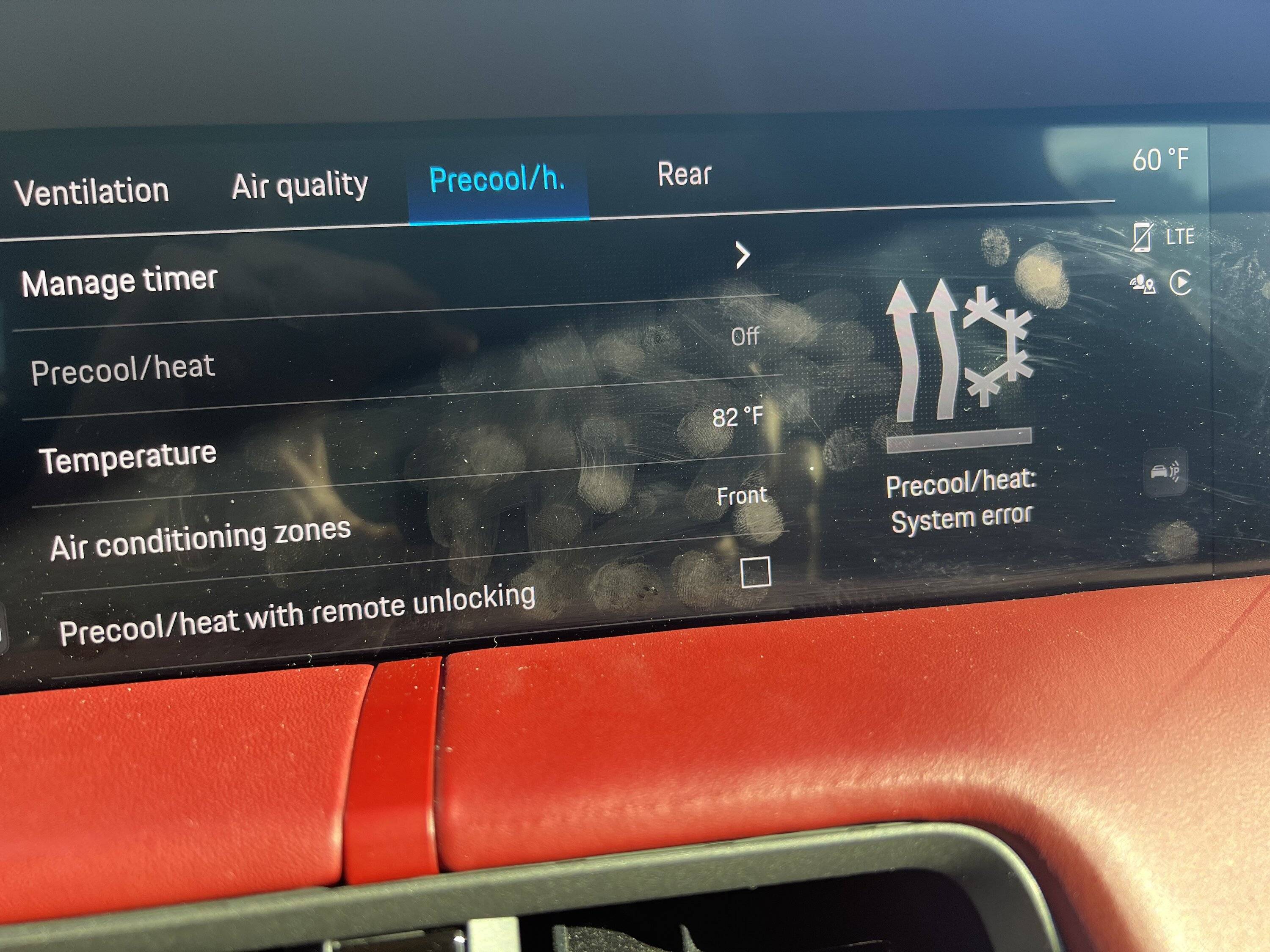

Scanned back though recent pages here but did not see straight off - is this the typical system error people are seeing when their heater fails (in the Pre-cool page)?
Mine failed to produce any heat this AM and had the App (pre-heat) notice prior and this PCM error in the car (but no more obvious error in the PCM dash!) - again normal/typical?
Sent a note with this pic into SA and assume he'll set up a visit.
Yes that’s the one.
