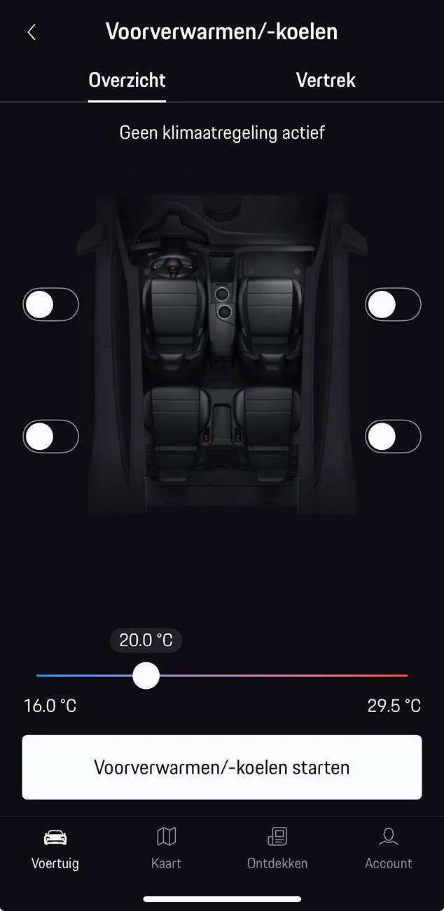

Untill last monday the app and climate functionalities worked great. Since then, the app can’t connect to the Taycan anymore. Raised a ticket with Porsche connect and they are checking the central server environment. Happened to me last January, just shortly after delivery. Also planning a visit to the dealership if the problem isn’t solved by coming Friday.

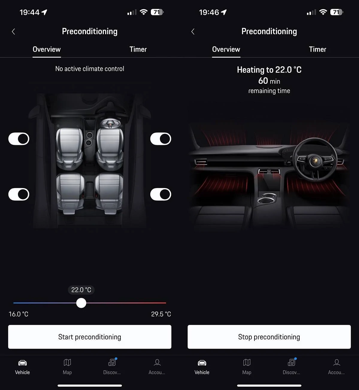

Does anyone have a screen shot of a working 2 zone app please?
Ta.
I posted mine from Saturday earlier in the thread. It’s still working so here it is again …
