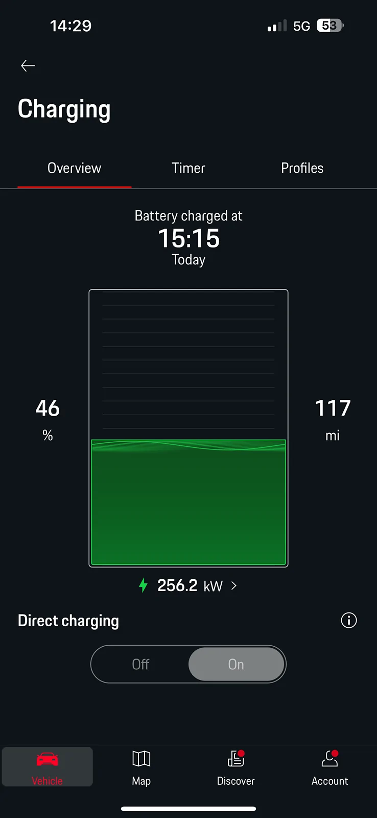

I used to see that issue, but the last few times I've charged at different sites I've consistently seen 250 kW + up until around 50%. Preconditioning is necessary to achieve peak rates. That's another benefit of the v.2 Taycan...it doesn't seem to need any significant preconditioning unless it's below about 40º F outside...you don't have to choose between range-wasting preconditioning or slower charge rates.

Porsche Taycan Kyle Conner goes 311 miles in '25 Taycan 70mph range test IMG_2011.PNG

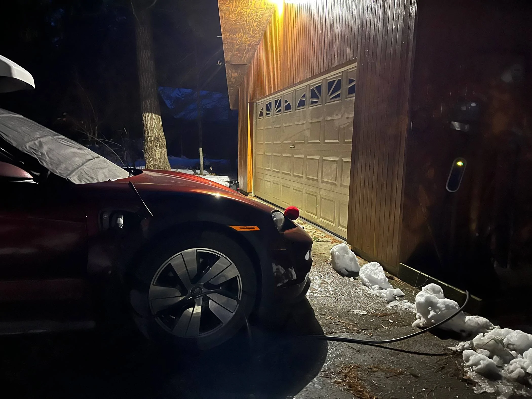

(raises hand slowly) In my defense, they’re winter wheels (and just great!). Also, I don’t take myself too seriously, as proven by this photo:
Porsche Taycan Kyle Conner goes 311 miles in '25 Taycan 70mph range test IMG_0468
