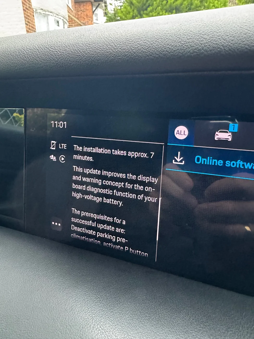

What does Porsche mean with 'Display and warning concept'?

I had to examine the wording. In German, “Konzept” (concept) is not the same as concept we are familiar with. Instead, it refers to a software strategy or logic. Is this a poor translation?
Please, German forum members, is my assumption correct? Is the word “concept” being misused?

The vehicle is currently participating in an online remote update campaign- WST2.
Control unit to be updated:
-Battery Management Control Unit of the high-voltage battery
Issue to be resolved:
-Improvement of battery monitoring and user warning in the event of an irregularity in the high-voltage battery

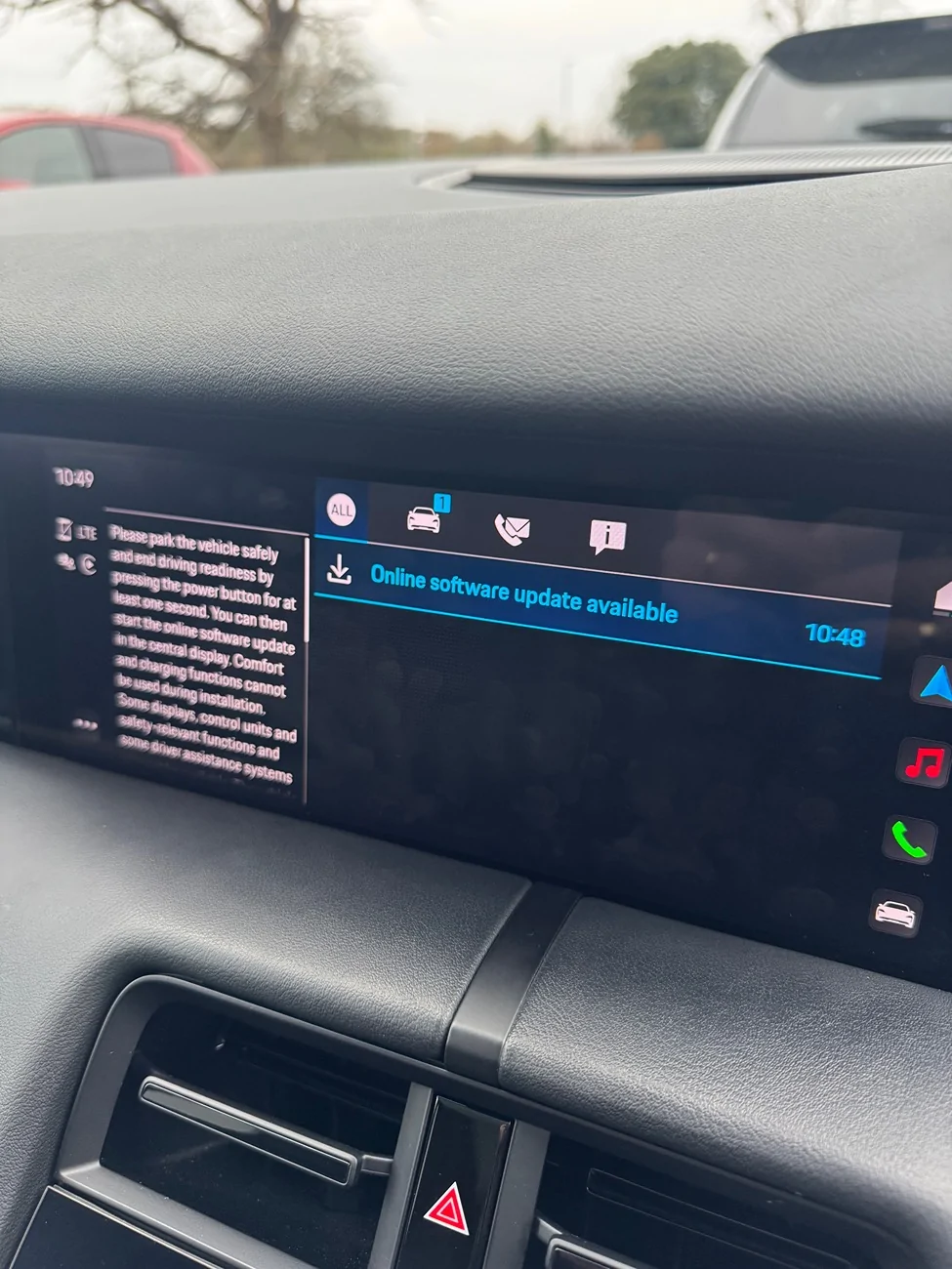

It's right there!
Click on it next time.
Porsche Taycan WST2 OTA update IMG_20251208_114657008_HDR~3
Honestly....🤦🏻‍♂️
Perhaps we need another update to "update the display of OTA update description concept". ;)

Honestly... It's not there :p ;)
Clicking on it opens a menu with a single entry - to read the text on the right.

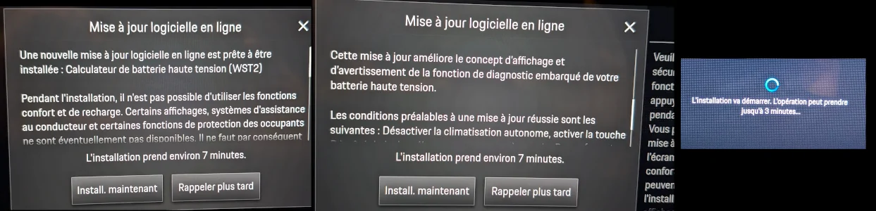

Some more info is displayed after switching off the car, when hitting the button to process with the install. Translation:
High Voltage Battery Calculator (WST2)
<info about features disabled during the install>
This update improves the display and warning concept of your high voltage battery's on-board diagnostic function.
<info about how to launch the install>
