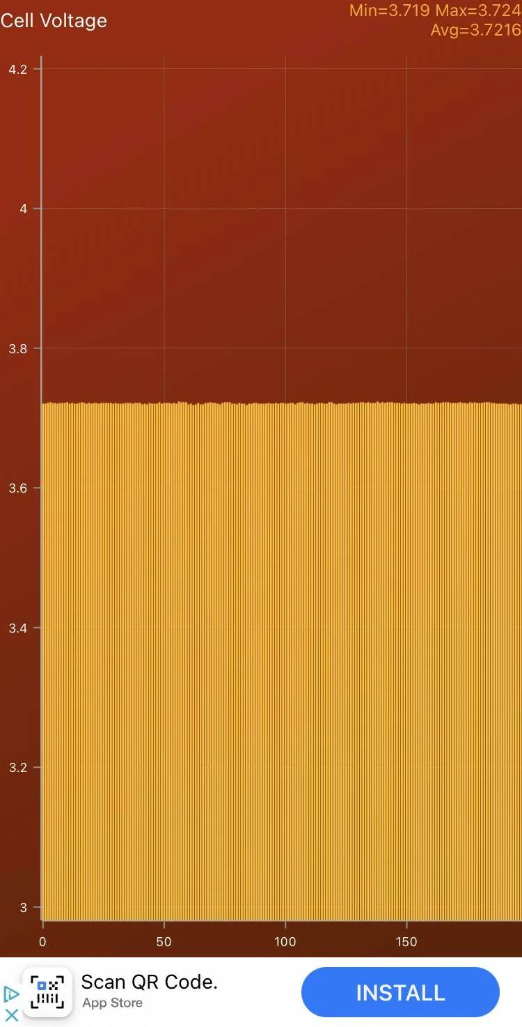

Latest updated readings for you...
Current SoH - 95.12%
Current Mileage - 10281
0 new DCFC sessions since last update
0 charges to 100% since last update
20-85% is my typical SoC at any given time
I'm so happy that the intense, triple digit heat has subsided. One thing to note about my setup, I don't have a climate controlled garage but I did install vents in my 2 garage doors and a vent fan in my garage ceiling that runs all the time when it's hot. It's still hot in my garage but the attic fan and garage door vents help to keep air moving.
Cell voltage distribution looks good...

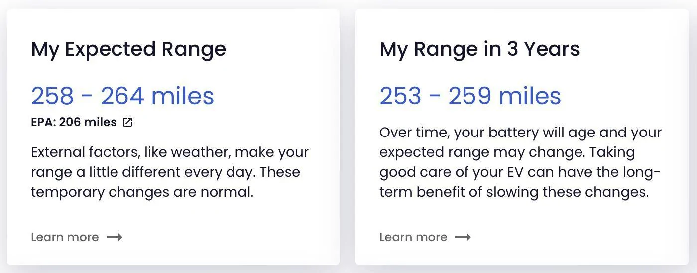

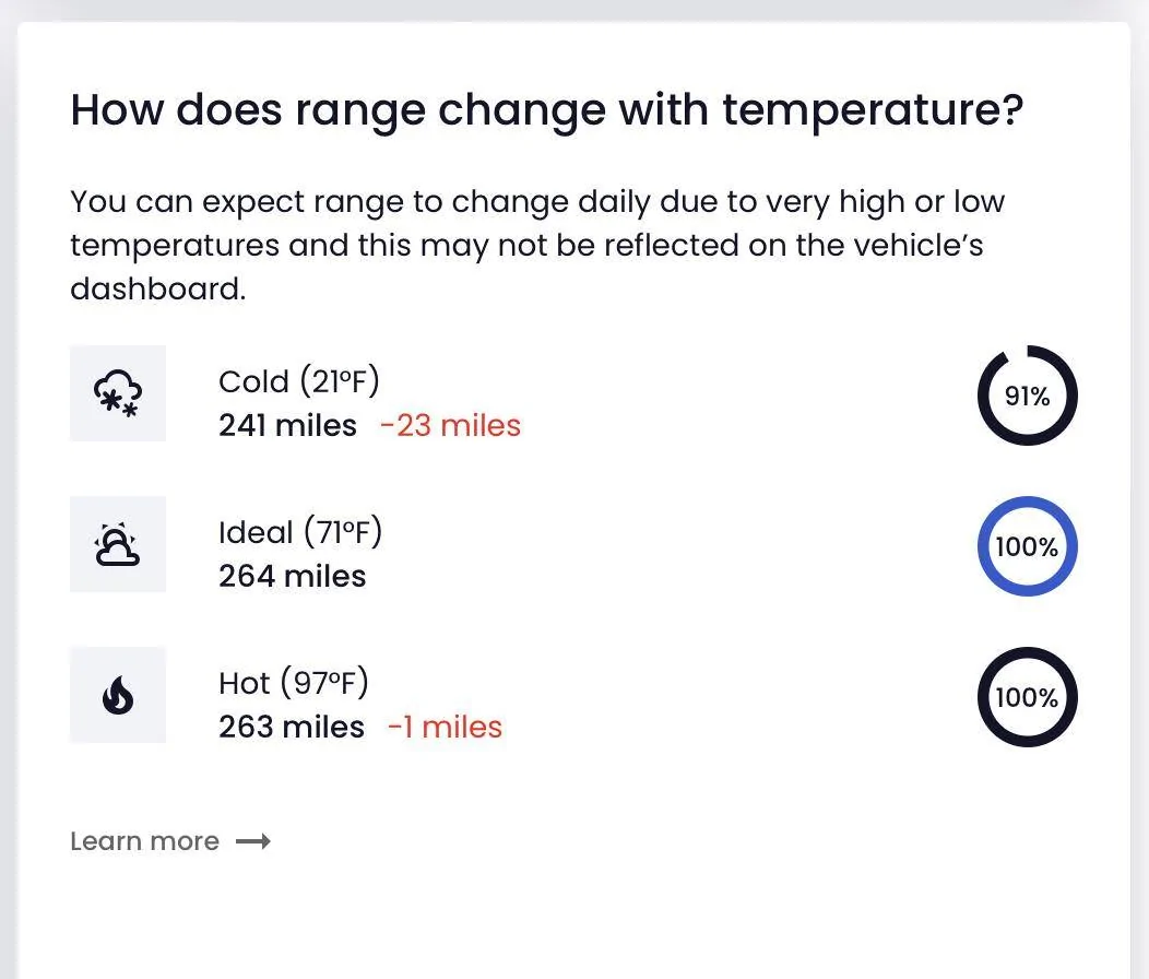

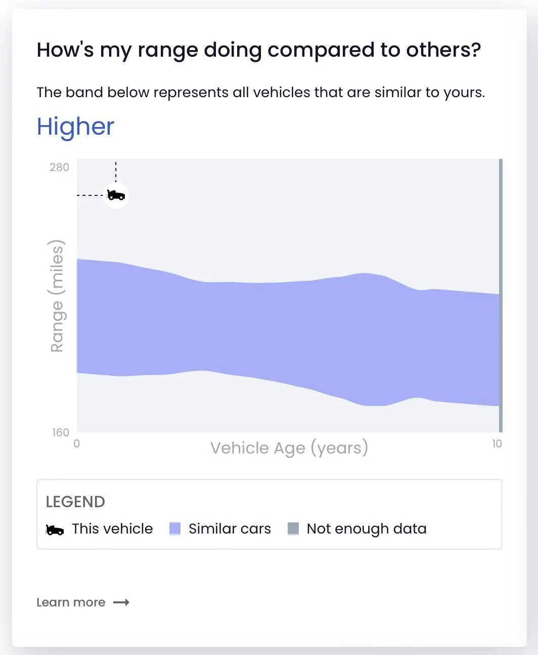

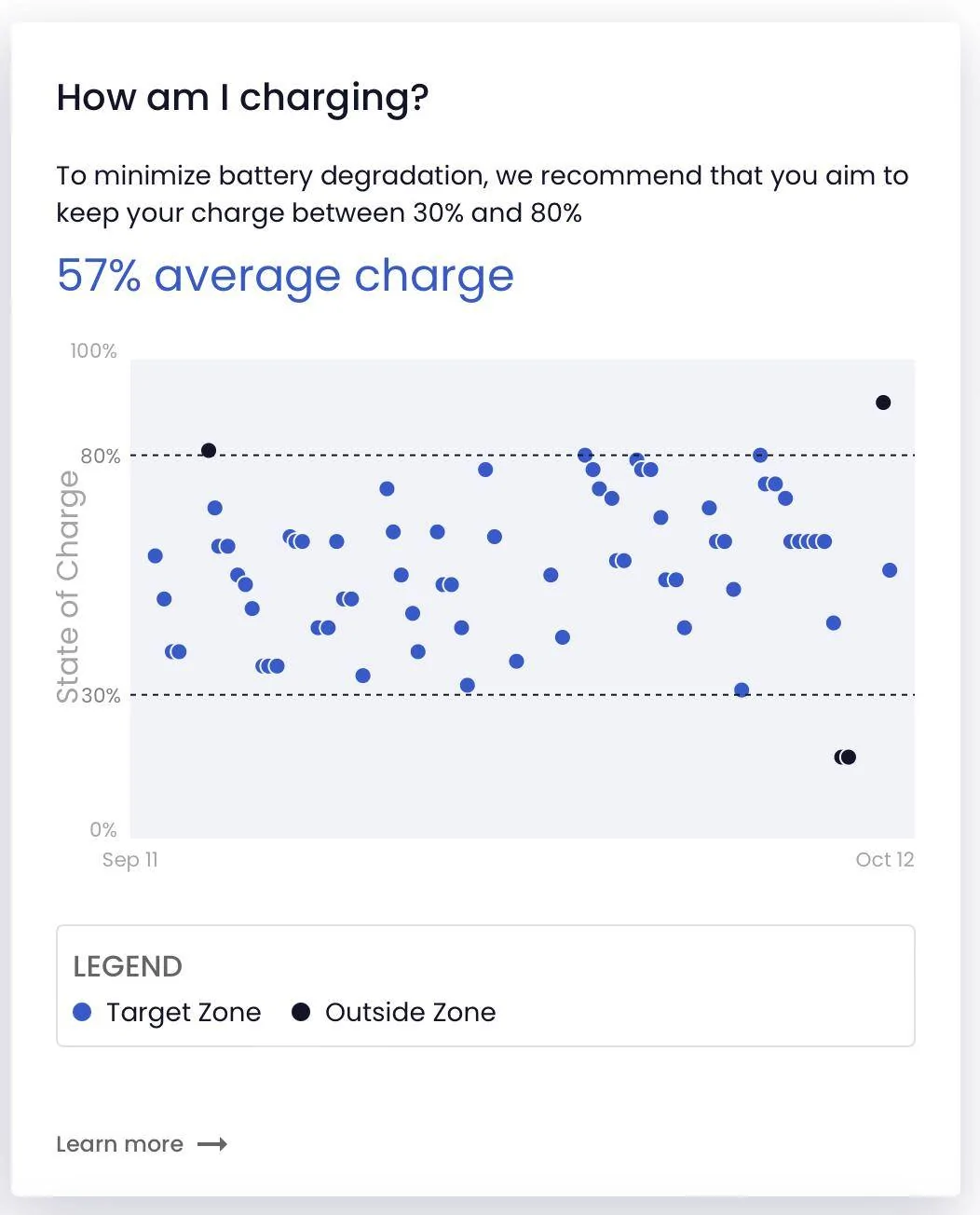

@ciaranob updated readings for you...
Current SoH - 95.00%
Current Mileage - 11,487
1 charge to 100% since last update
Also, I’m letting recurrentauto.com track my charging and range stats. Will post those in a minute I posted those screenshots below as some additional data that may or may not be interesting.

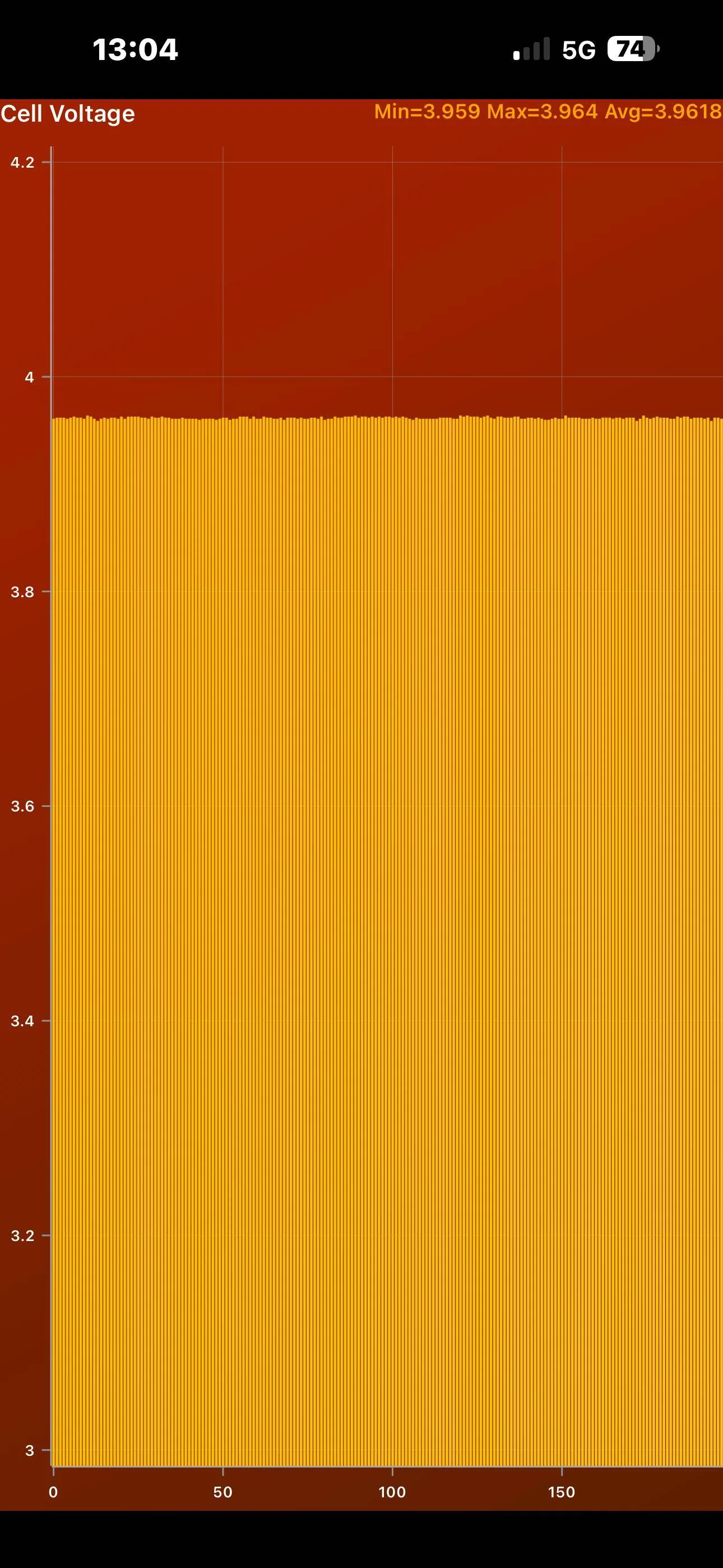

So here is my update after the battery repair.Two new modules fitted and a new HV Battery control unit. BTW I strongly question the data from the car to Car Scanner!! But this is what is shown!
Car is at 55,420 km now when I drove it home from my local Porsche centre.
SoH. 99.82%
And all cells are equally balanced!
Porsche Taycan Baseline for HV Battery SoH Performance IMG_0982
Porsche Taycan Baseline for HV Battery SoH Performance IMG_0983
Range at 100% calculates to over 420 km’s!!
Interesting from CarScanner would be that the total battery capacity now woul be close to 87 kWh!
68.9 kWh divided by 78.8 % SoC. = 87.4 kWh???
I just can not believe any of this!
Interesting though is that with a trial of Tronity app, I could see that they estimated my consumption to be 38 kWh/100 km on a trip that the POrsche app reported 19.x kWh/100 km. I think Tronity estimates the battery % consumed of the available capacity, while Porsche reports what the car has consumed. Quite easy to see when the battery trouble started to show now.
@ciaranob I have no idea on what to make of this data in your graphs??
