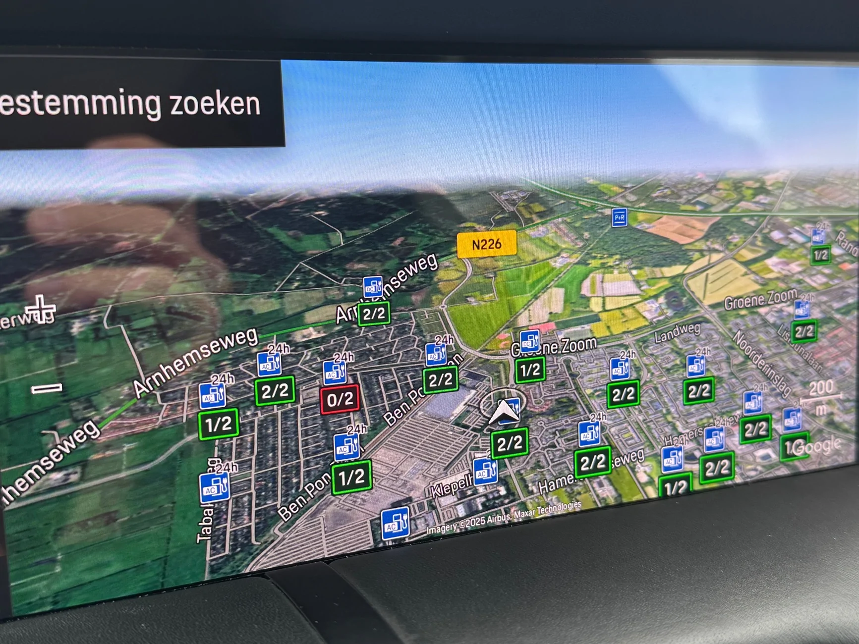

I don’t want to celebrate too soon, but I just picked up my car again. Several software updates were installed, IIRC I heard a total 16, including the PCM upgrade to 3885, new headlight software (recall), and even a new version of the navigation app. My Porsche Center did see a lot of issues in the logs related to the navigation software. The navigation feels smoother than I can remember, and I’m also seeing new icons (see attachment). Maybe I was really behind on updates, but the blue icons for AC and DC charging points are new, right? On the 15-minute drive home, I didn’t experience any issues.

Will check if my car shows chargers, but I think it does and has for a long time, will edit the post later

I just completed a longer trip with plenty of city navigation, no issues at all. And it really seems smoother as before. The PCM was updated, and the service rep mentioned that the navigation system had been throwing a lot of background logs. My navigation pack turned out to be corrupt, which explained the missing software info I reported earlier in this thread. They were instructed not to replace hardware, but to try software updates only.
I don’t have a full list of everything that was updated, but I recall hearing there were 16 updates. That number sounds a bit high, so I might be mistaken.
Since today, I’ve also noticed some UI changes in the navigation. I’m not sure if all my earlier issues were related to the corrupt pack, or if something else was wrong with my vehicle. Do you also see blue icons for charging points? They used to be white for me. My uneducated guess is that the navigation app update did the trick.

My charging points were always blue.
