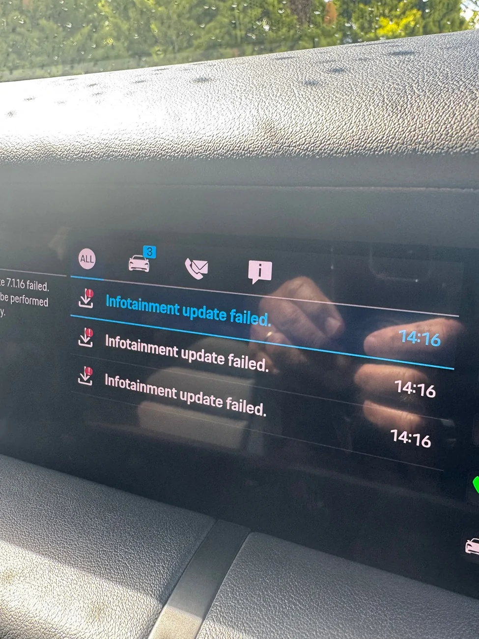

My early reports were positive and still all good @smoothound. Navigated west of London to Hackney and back over the weekend (thanks for that TfL) so it coped with routing/charger density there OK.
Only thing preventing me from allowing smartmobilty to close the case is some infotainment OTAs failed. I wonder if these are the pcm app updates people have mentioned, but in any case WTG1 includes reprogramming OTA so want to see some OTA success.

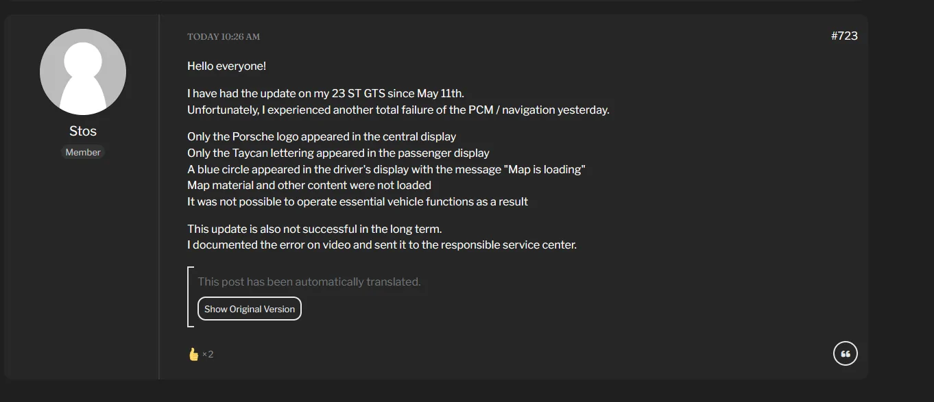

Oh boy...
the logo's and the spinner indicated a full reboot. That is even worse than just a crashing navigation app. But the "good" news is, this is a safety issue, so needs to be fixed quicker than 11 months.

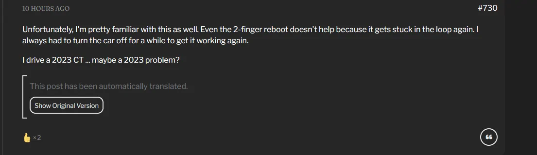

2 people with the update started reporting that the issues are still there. For now both cars are 2023. Stos has had his PCM hardware replaced earlier this year also, so new pcm + WTG1 - and still the issue.
Oof. That’s bad! I think I’m gonna deal with my occasionaly stuttering Navi for now. Nothing about that we can’t handle and at least everything else is running smoothly :)
