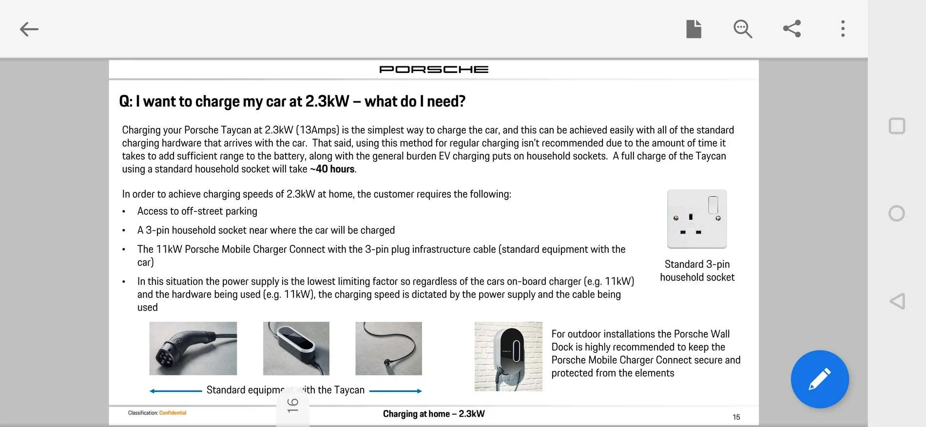

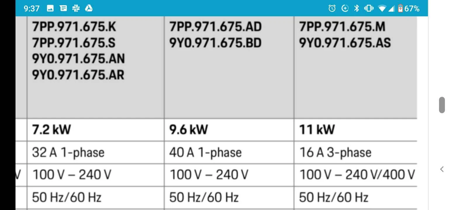

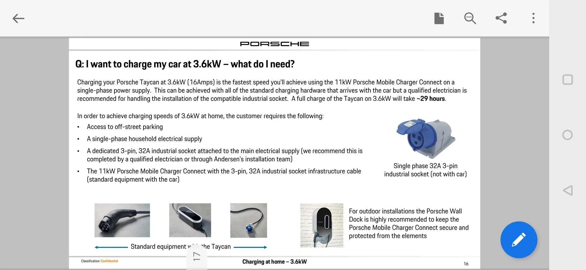

If I read correct I could get a 32amp socket installed and use the Porsche charge at 3-7 kw depending on what to believe at the moment.
If I get a dedicated charger, can I do that before the car arrives and claim the grant, or do I need a car before the grant.
Not sure whether to choose:
BP chargemaster
Zappi
Anderson
Any suggestions welcome
