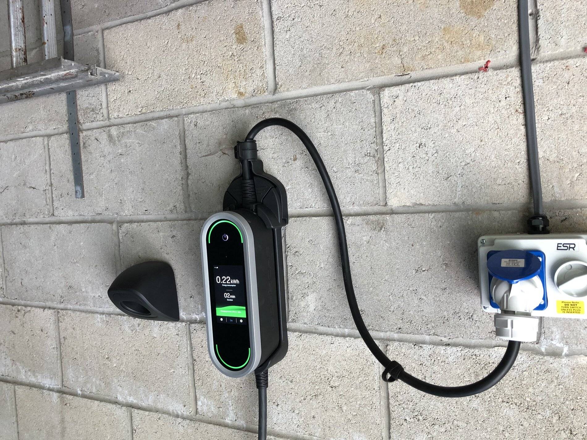

i am running the same. you can change the current setting on the charger and It will also adapt automatically to the supply current. Here a pic of mine

You can get a max of 7.2kw at 32amp single phase, which is more than enough for an overnight charge

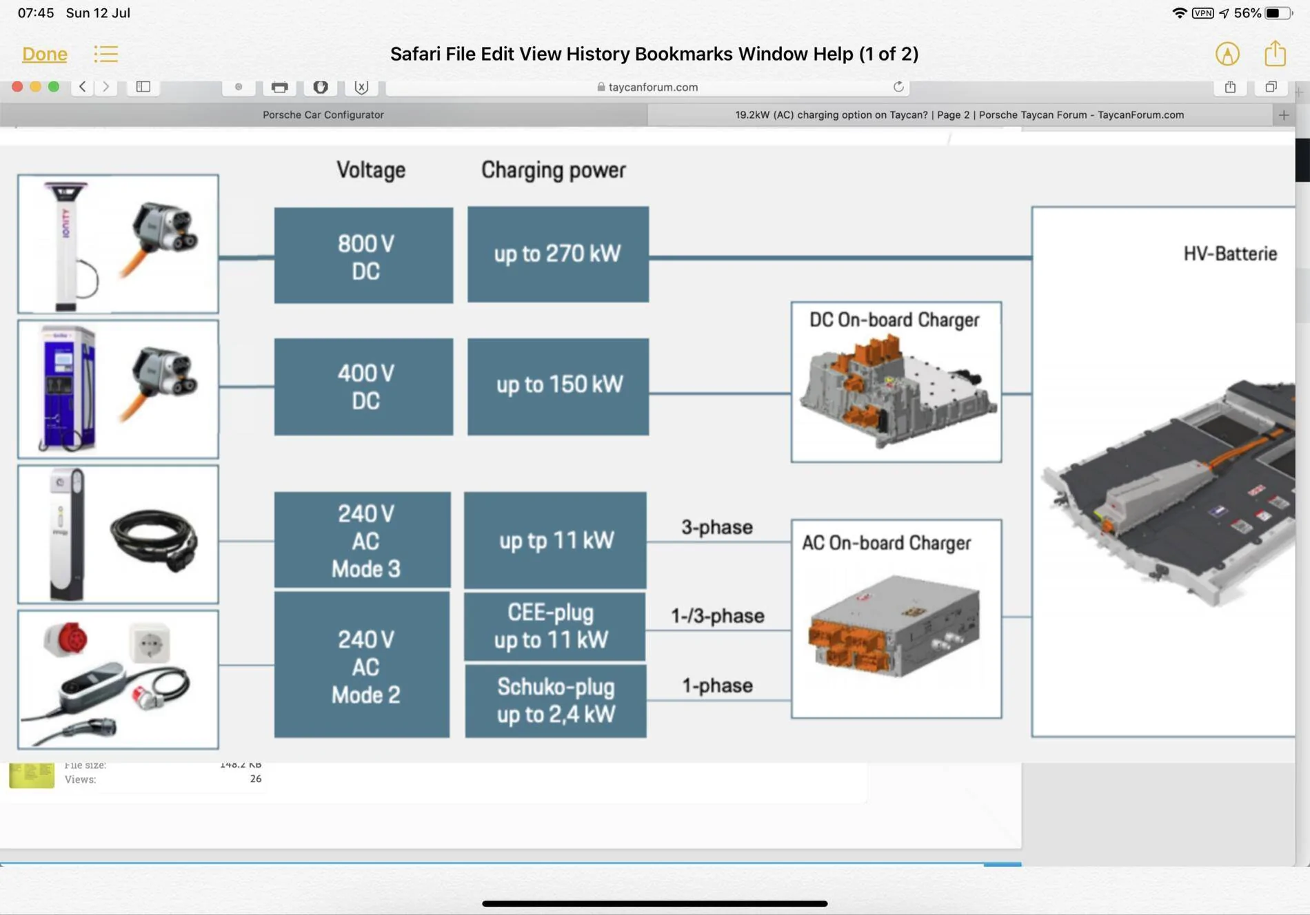

How do you know that the car will only take 11Kw on a supply that can provide 22Kw ? Obviosly it can charge faster than that and it's a bit weird that Porsche supply a 22Kw charger if it can't use it.
Does that mean that the 22Kw Public charging points are no good for the Taycan either ? Will it charge at 50Kw ?

Current model will charge max 11kw AC. At DC chargers you can charge much faster up to 270kw. Next generation Taycan is reported to charge at 22Kw AC.
3,090
2,690
Correct! Here is a screen shot I have saved some time ago. I think it was from a slide set one of our members here linked to, but I could not find that just now.
