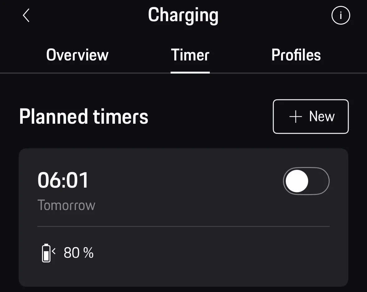

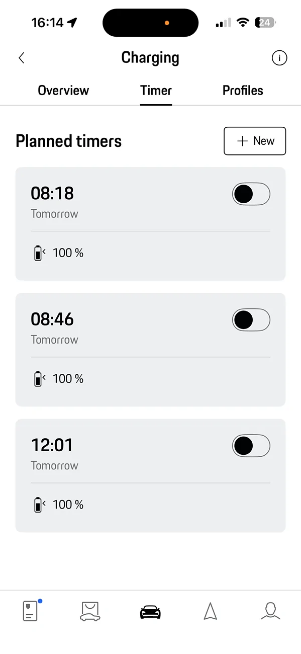

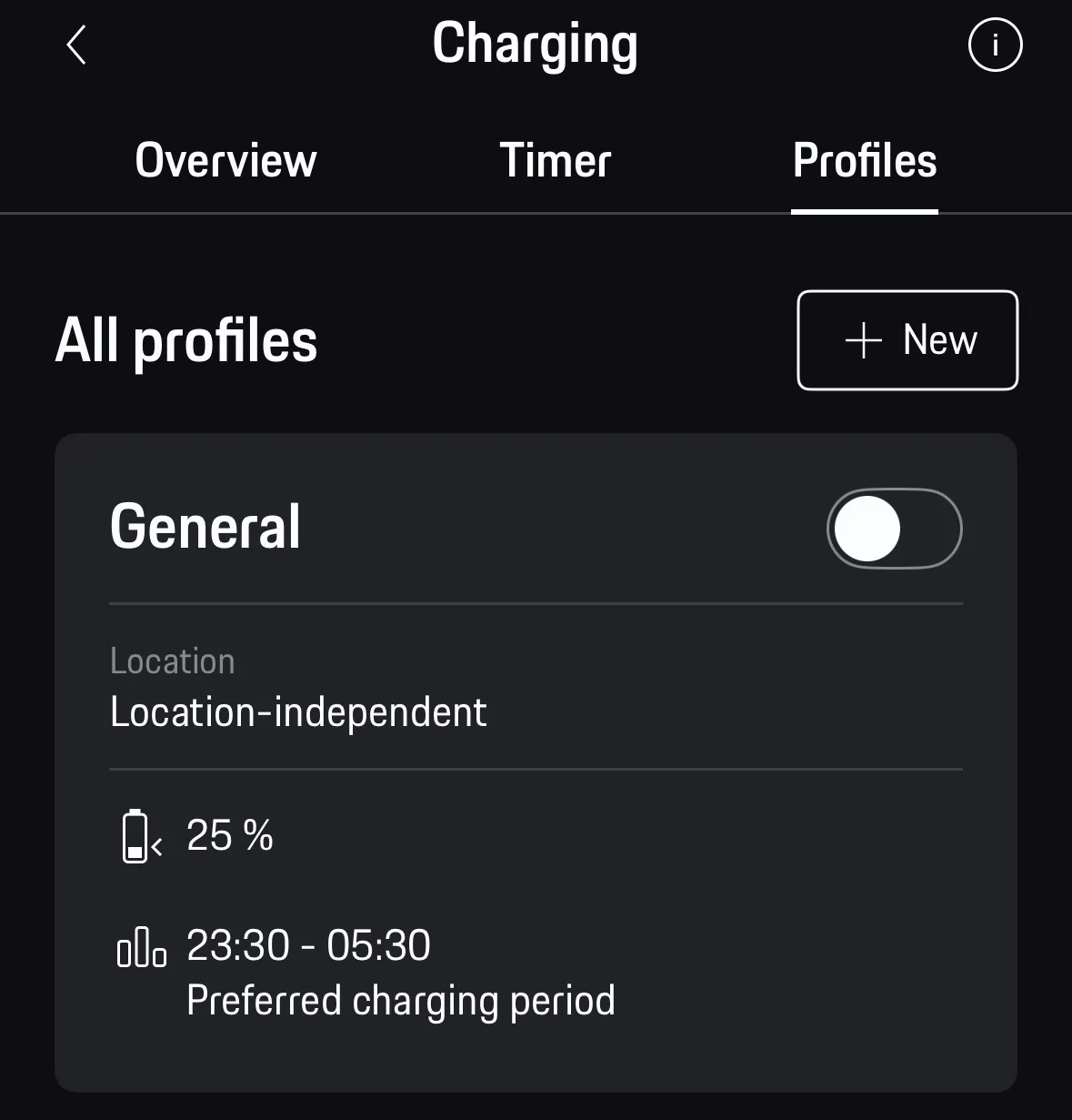

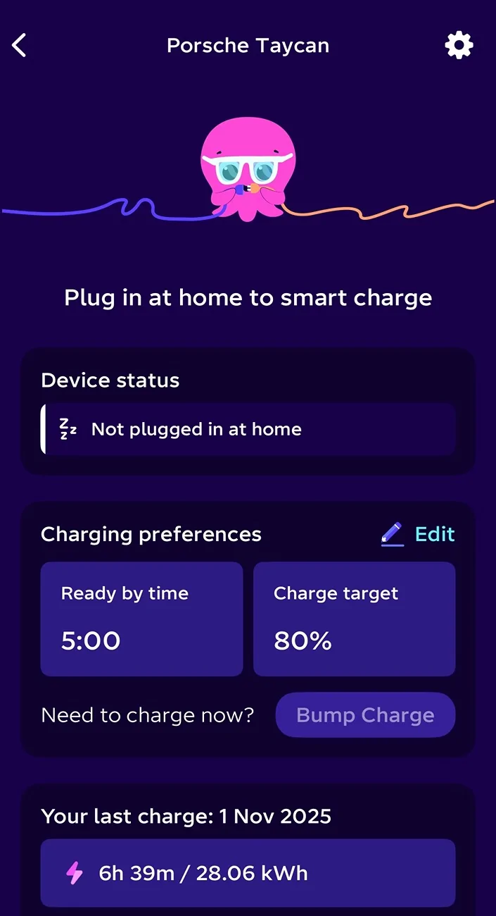

Not sure what you mean by a CoS slider, but the pics below from the Porsche and Octopus App may help.
Note because OIG is currently controlling charging my Profile and Timer are turned off.
I use the Porsche supplied mobile charger, which logs charging history to the Porsche App.
On going into the Porsche app to get these pics I found that OIG had again ignored its 80% charge parameter and ploughed on to 100%.
Both times this has happened, the car had remained plugged in for a couple of days after the 80% charge had completed. I’ve asked Octopus to investigate and fix this.

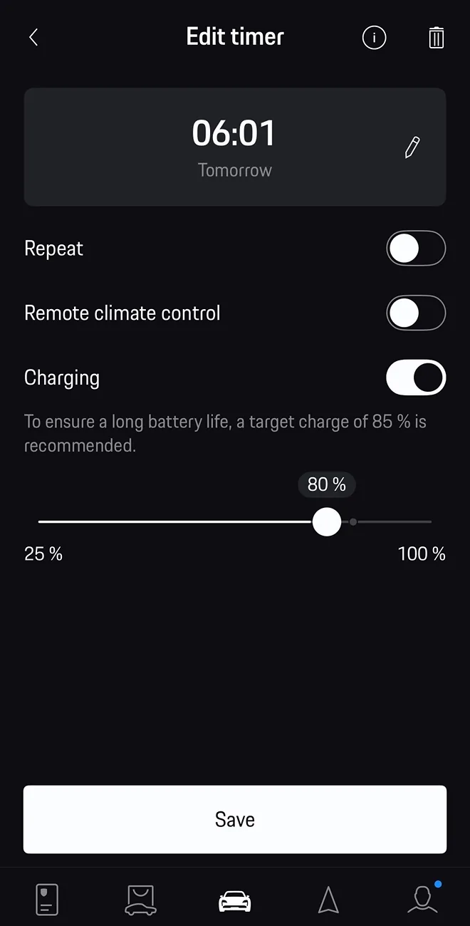

Porsche Taycan Intelligent Octopus Go IMG_4160
This is likely the target SOC slider you’re referring to - the 2nd screen in the Porsche Timer dialogue.
As shown in the earlier Porsche App pics, both the Profile and Timer have been switched off, to allow IOG to do its thing - which includes disregarding its own target SOC if it has already reached that on a previous day and the car remained plugged in.
