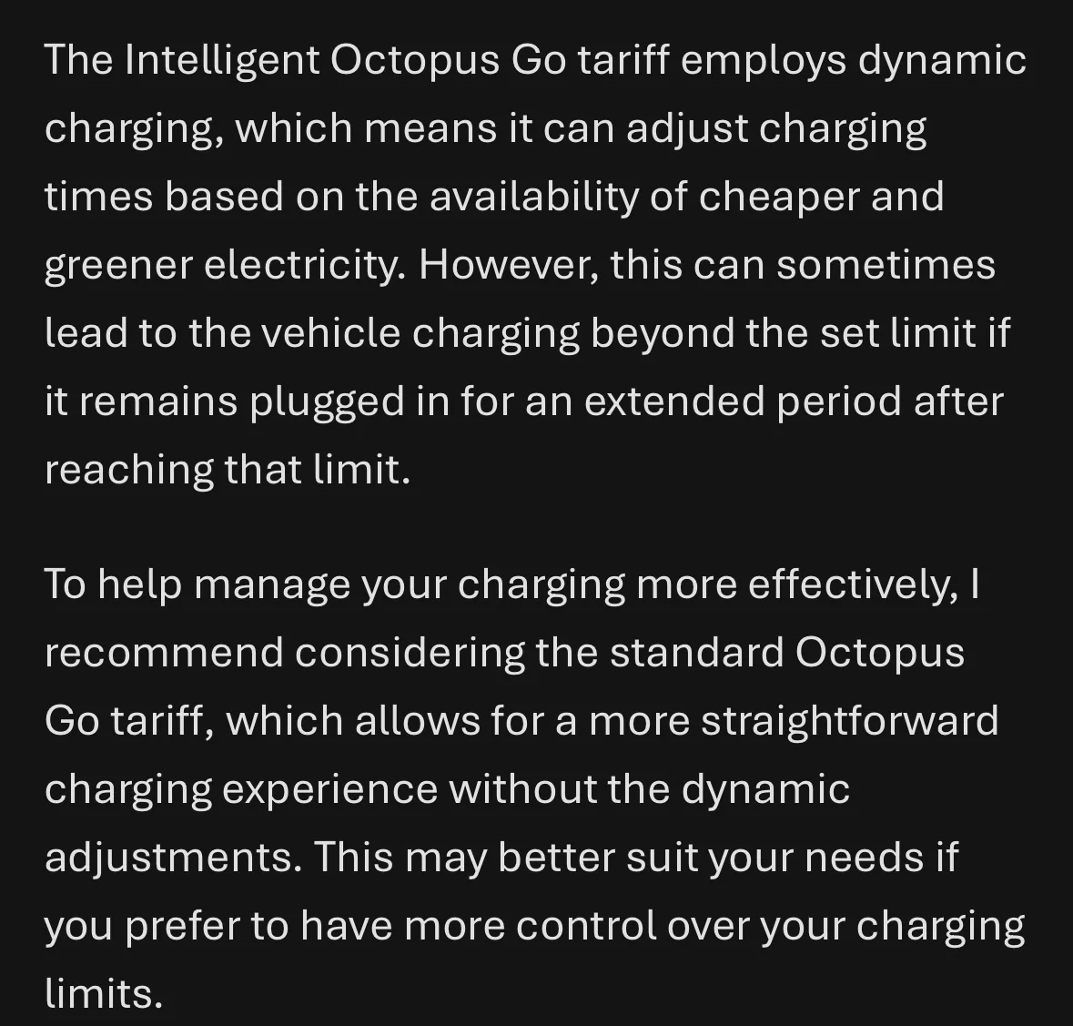

My problem - charging past 80% and continuing to 100% - occurred only when I left the car plugged in for a few days.
I did see that it had stopped around 80% after the first night.
Octopus have now responded to the ticket I raised:
I’ll challenge this reply.
Mine used to change to the set level (say 80%) on the first night.
But if I left it plugged in, it would then charge to 100% the next night. I seem to remember others saying similar on here.
Yep, I see the same behaviour.

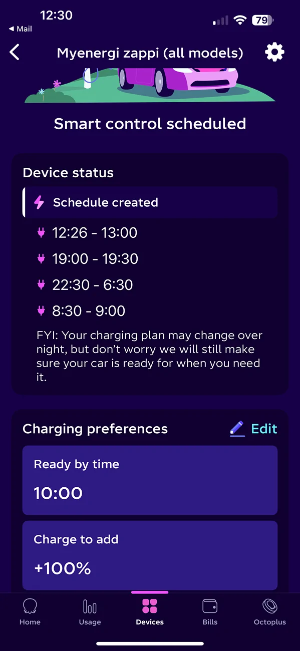

Wow. I‘m currently getting 9.5 hours a day of cheap (£0.07/kWh) electricity when Intelligent Octopus Go controls my Zappi charger.
Way better than the fixed 6 hour 23:30 - 05:30 window and at times when I’m actually awake to make use of it!
Porsche Taycan Intelligent Octopus Go IMG_2579
I can still use the car’s inbuilt timer to limit the state of charge to 80% too:rock:
This is exactly what I do.
Is that 100% reliable?
Does the 80% Porsche timer override the 100% OIG app setting?
I assumed active OIG profiles/timers would take precedence/get confused by any others that are enabled.
Do you also have an active profile and if so what are the hours?
Are there any settings on your Zappi charge, or are you just using the OIG app?
If this config works for you it may work for me.

This is exactly what I do, too.
Yes.
Does the 80% Porsche timer override the 100% OIG app setting? I assumed active OIG profiles/timers would take precedence/get confused by any others that are enabled.
Yes, the Porsche timer ultimately controls when charging stops (I actually use a single profile set to 75% and no timer). Note that OIG is controlling the Zappi charger (EVSE), NOT the car, so timers/profiles aren't set or affected by Octopus. Also note that the 100% set in the Octopus app is a request for how much charge to add, which dictates the total charging time Octopus then sets, but when the car reaches its desired max charge it refuses to take more.
Charging times are controlled by Octopus and the wall box; no need for any time controls in the car.
Zappi is controlled by Octopus using the requested charge-to-add and ready-by time set in the app.
1. Yes, 100% reliable
2. The 80% Porsche timer overrides anything Octopus tries to do via the Zappi charger. The car simply refuses any charge if it’s at 80% SOC already.
3. Octopus can’t communicate with my Porsche because I don’t pay for Porsche’s Connect Services. Consequently no ‘enode’ profiles or timer get set in the car.
4. I have no profile set in the car and just 1 daily recurring timer in the car limiting charge to 80%
5. I simply use the OIG app. Nothing special in the Zappi.
