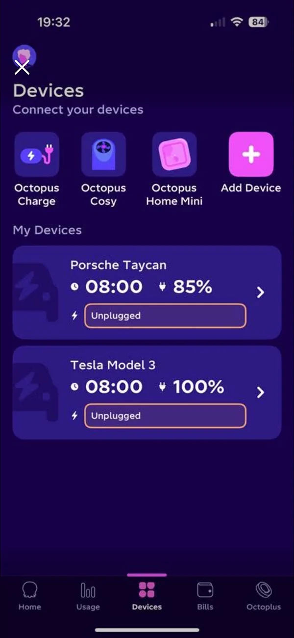

Apologies to the thread starter for using this, but it is an OIG question. I've had no issues with mine, set 85% and just plug in when i'm at 40 - 50% and it seems to work well. We've just bought another EV but i know OIG only allows one linked car, does anyone charge another EV using its own timer? Does this affect the operation of the Taycan OIG charging when following a non linked EV? It should be fine but thought I'd ask.

Leccy61
Nov 18, 2024
326
241
Taycan Cross Turismo, 986 Boxster S, VW ID.3 Pro S
Interesting @Silent Assassin and thanks for sharing that! I’d seen the changes in the devices part of the app but didn’t realise it included being able to add another EV. I’ll see how it’s gets on with our ID.3 which is currently using the 23:30-05:30 window via its own timer.

I didn't know you could add another vehicle, but checked and my new one is not compatible. Looks like two cars will work with the timer plus IOG for the Taycan.

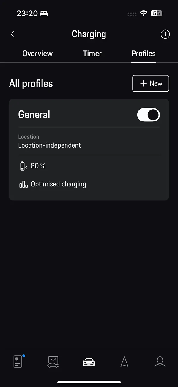

Yes, the Porsche timer ultimately controls when charging stops (I actually use a single profile set to 75% and no timer). Note that OIG is controlling the Zappi charger (EVSE), NOT the car, so timers/profiles aren't set or affected by Octopus. Also note that the 100% set in the Octopus app is a request for how much charge to add, which dictates the total charging time Octopus then sets, but when the car reaches its desired max charge it refuses to take more.
@tophamn so in essence your process combines -
1 ) Octo IG controlling your charger to supply power whenever it's at 7p, and
2) a Car Profile STOPPING the charge when it hits your nominated %
Yes?
A profile like this, with 'optimised charging' selected?
Porsche Taycan Intelligent Octopus Go 1762990011805-um
I hope I understand correctly. Would not have expected the set % to prevent charging to 100%, but will be trying your setup, thanks!
***edit*** tried this last night and all smiles. I think knowledge about the use of this Profile setting, but then without any Timers, is key for any Taycan owners using a smart charger + OIG. Thanks to all members who provided clarity over the last page or two.
