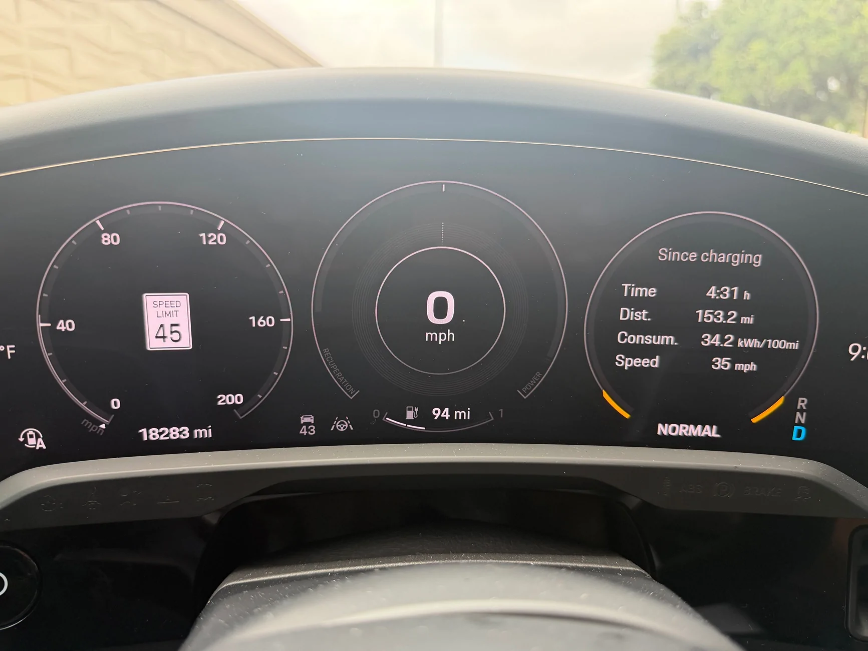

Pushed it hard yesterday during a spirited 2 hr 80 mile drive across the Texas Hill Country, reaching 100mph at times, 90% in Sport or Sport Plus. Dropped the range some but not a lot.

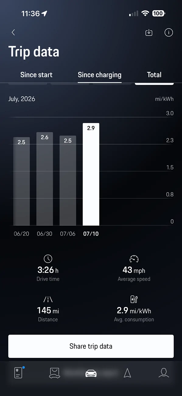

As for me, alas still no discernable range gain from the OTA update: yesterday I drove a 146.5-mile loop, in optimal temperatures but mainly suboptimal speeds (both too slow and too fast), using up 61% SoC, so extrapolated 240-mile range.
Efficiency was better than the prior day's roundtrip drive, which doesn't make any sense, since the range was lower!
But extrapolating from that, my SoH is 93.1%, which is respectable for almost 76k miles (almost 58k by me, w/ the first ~18k by the original owner) and with five months to go until the car's half-decade anniversary (and a little over a month away from my three-year ownership anniversary).

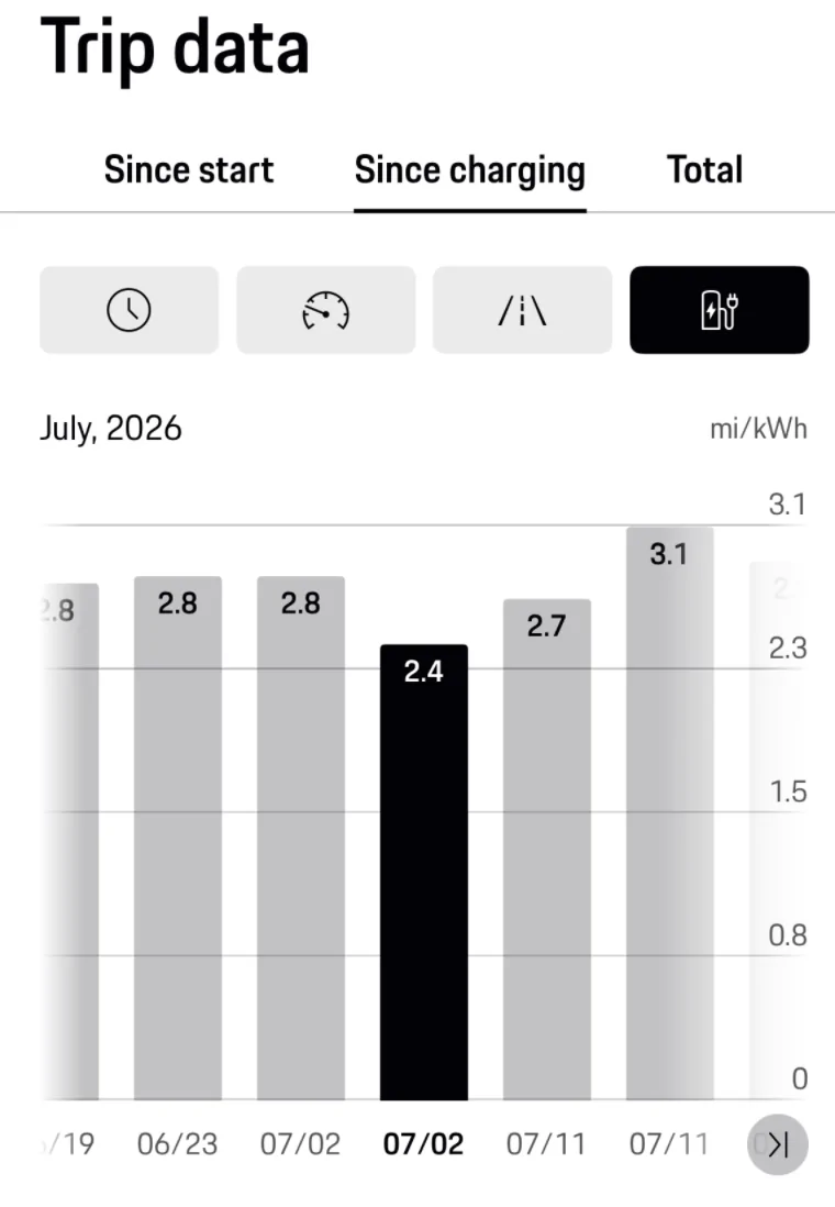

I thought I was imagining things - glad to read that others have experienced a range boost with this update. Now, for the MY21 Turbo S, the boos it barely enough to get to the grocery store - but I'll take it :)

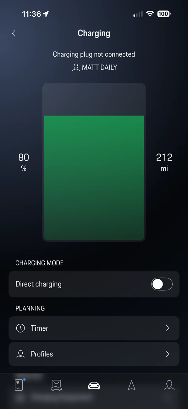

My J1.1 2022 4S CT just got an OTA update that included some tweaks to the battery management system. At 85% SoC, my range now says 242 miles (was around 220 before). Whether or not this translates to real world range improvement ¯\_(ツ)_/¯ but it’s nice to see that the J1.1 cars haven’t been completely forgotten.
I dream of 220 miles at 80% on my 2022 CT 4S. I have never had more than 208 miles at 100% in a year of ownership. Could be my driving style I guess
