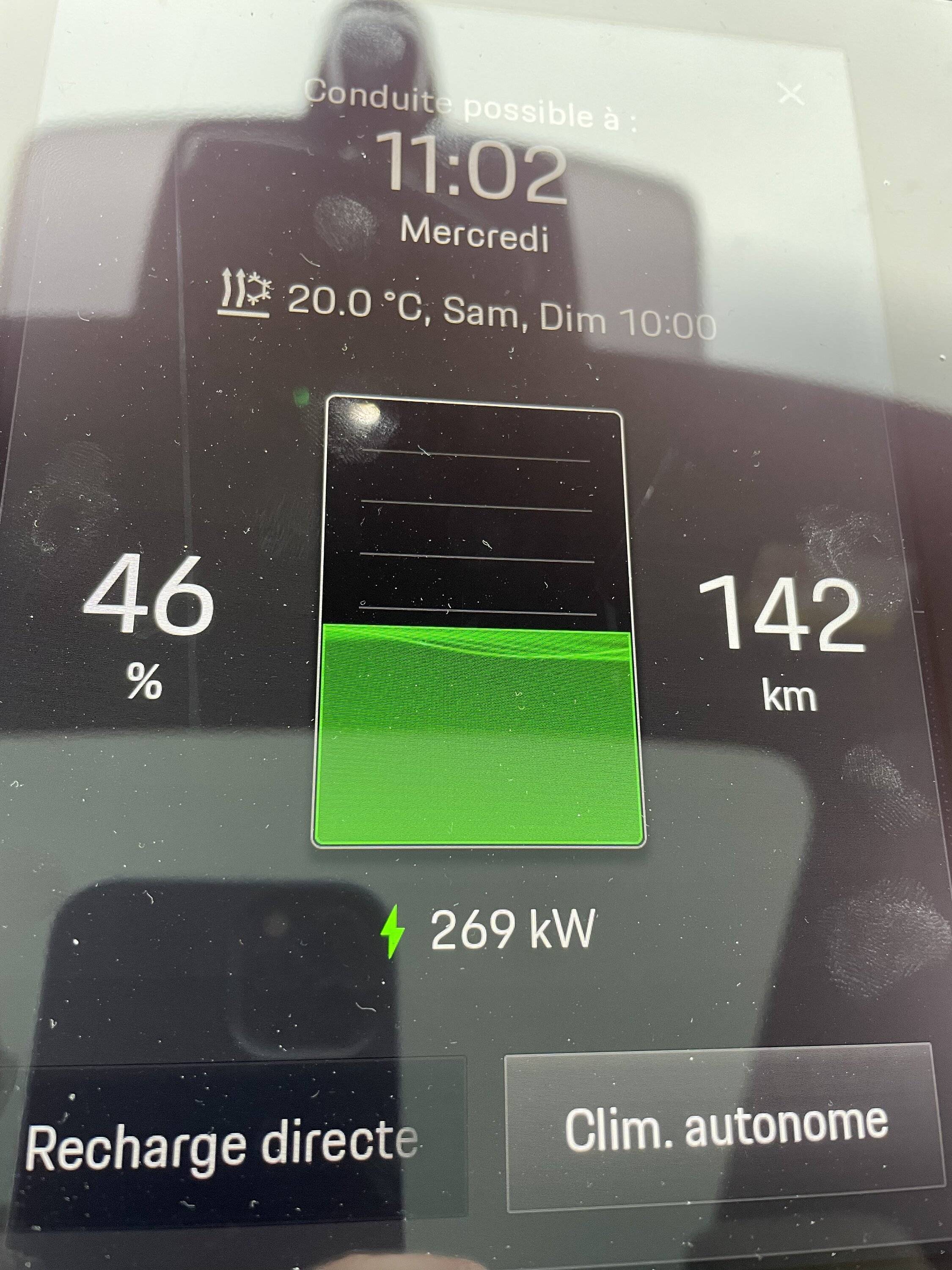

Porsche Taycan Fastest charge you've had? 357221A1-EB82-4DBC-9C2C-BE43AF120121
I got 269kW couple of times but never 270kW.
When I road-trip in Europe I always go deep and precondition the car.
If it’s Ionity, I’ll get more than 250 or there is a problem.
In other stations it’s often way less.

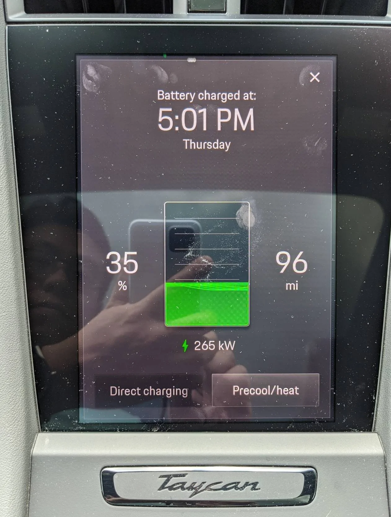

Looks like the folks on Ionity are closer to reaching that max 270kW! Here's my top EA charging rate at 265 kW.
Porsche Taycan Fastest charge you've had? Screenshot_20221219_222112_Photos
