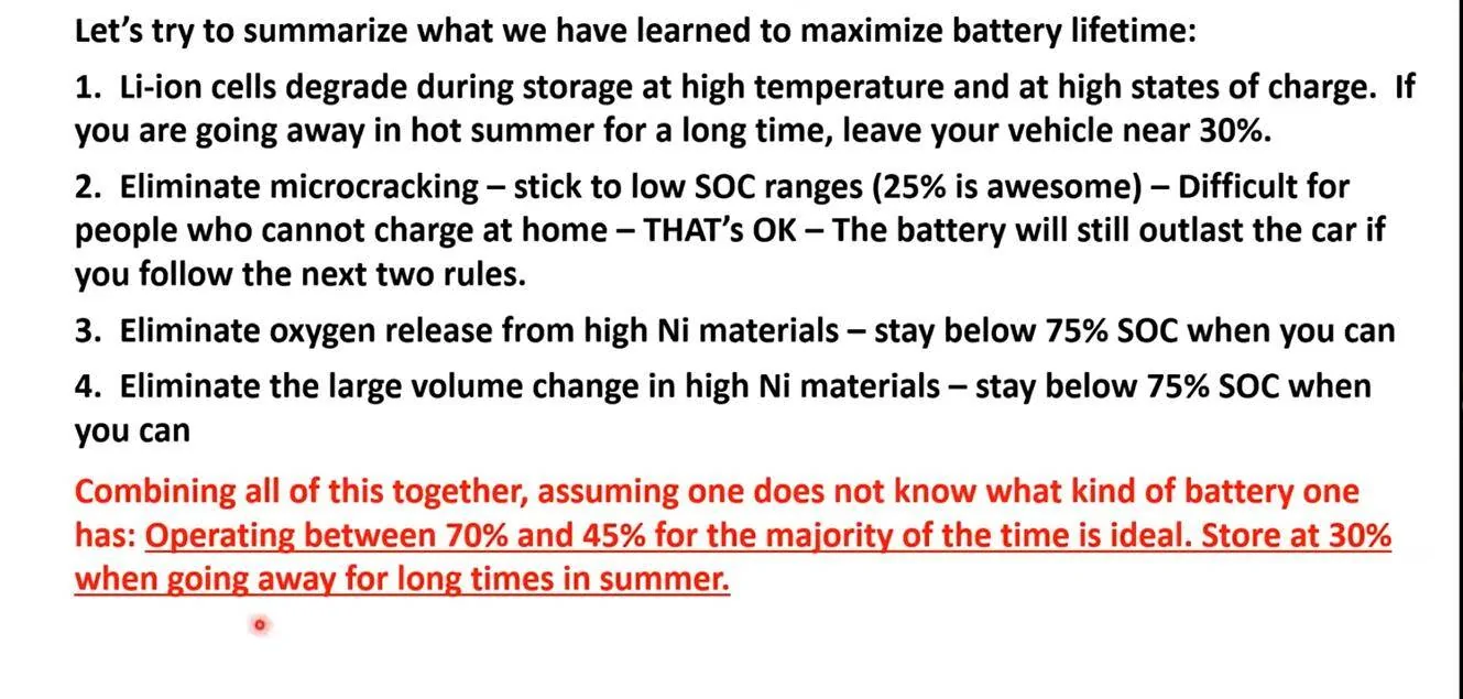

I don't know about consensus, but that's what the actual battery engineer in the video posted by Scandinavian stated pretty clearly.

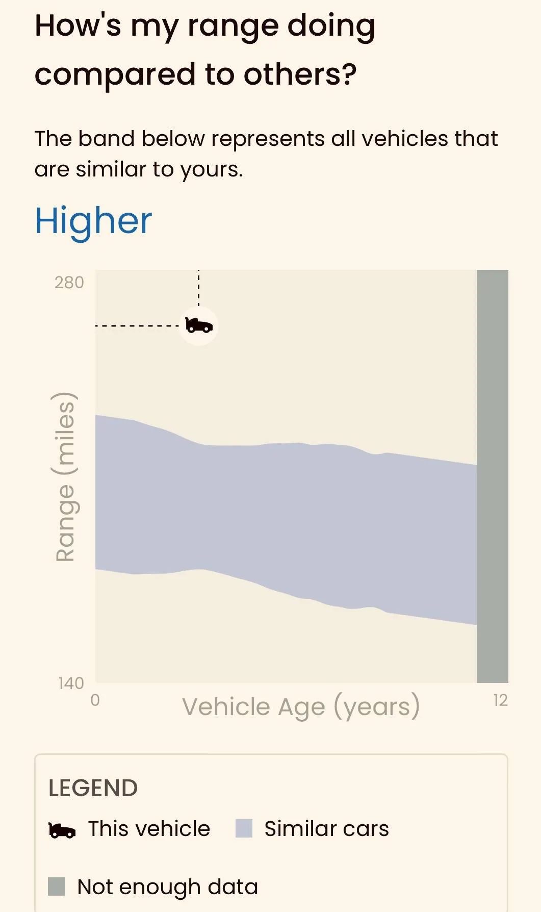

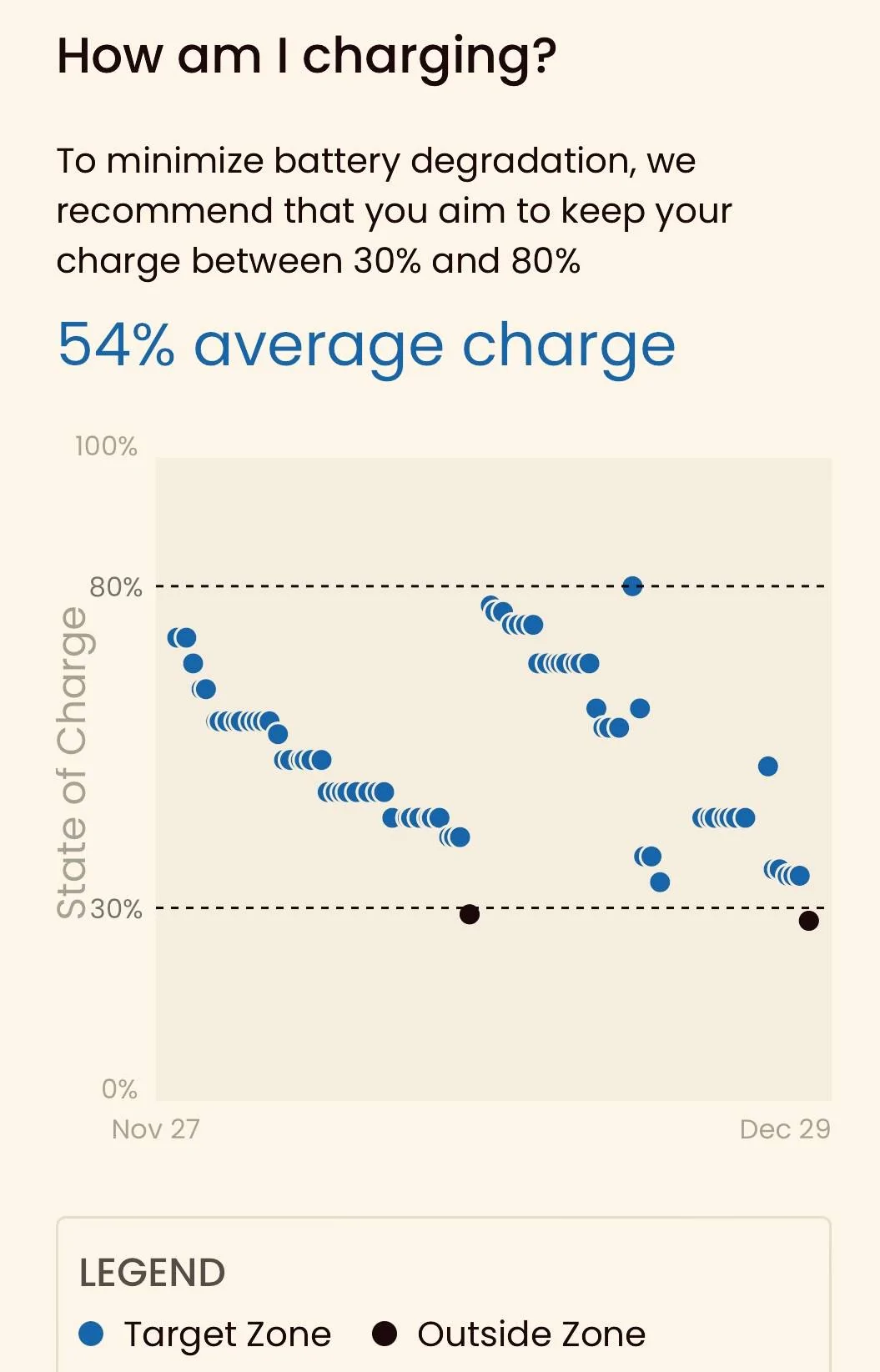

All interesting, thank you. I almost always learn a new detail or two in threads on charging. Recurrentauto.com collects information from a variety of EVs. You can add your own Taycan and get monthly reports on it, for free. For example, here are a couple of charts from my 2021 4S’s latest report. It’s gratifying to see that Taycan is well above most other EVs in range. Recurrentauto tracks your charging sessions; they recommend generally keeping the charge between 30% and 80%.

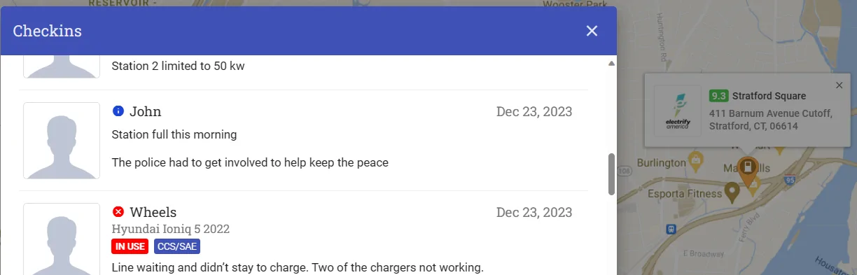

Did you happen to be trying to charge at EA Stratford CT on Dec 23? ;)
