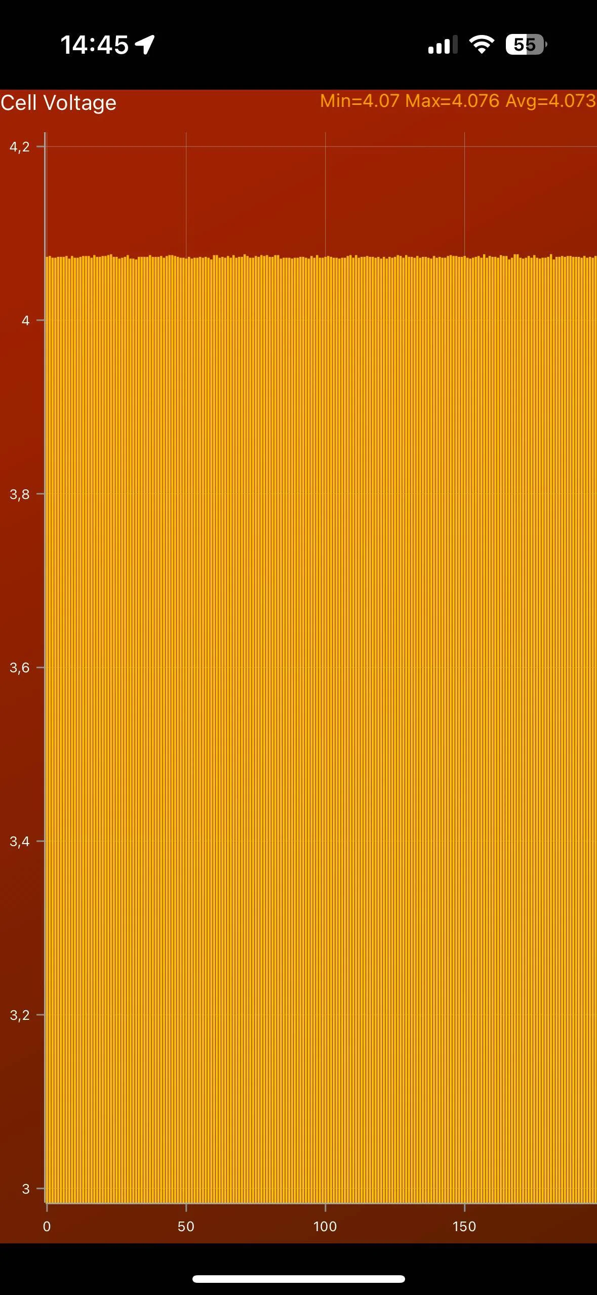

Attached my cell structure at 90% SoC. Charged from SoC8% with 2,1kW so more than 24H charge that gave good enough time to balance, according to @Dr Bob.
Unfortunately I forgot to take a picture at 8%SoC. Next time will do to extend this.
By the way at displayed 8%SoC the 'Real' SoC was 13% so 5% buffer at that stage.

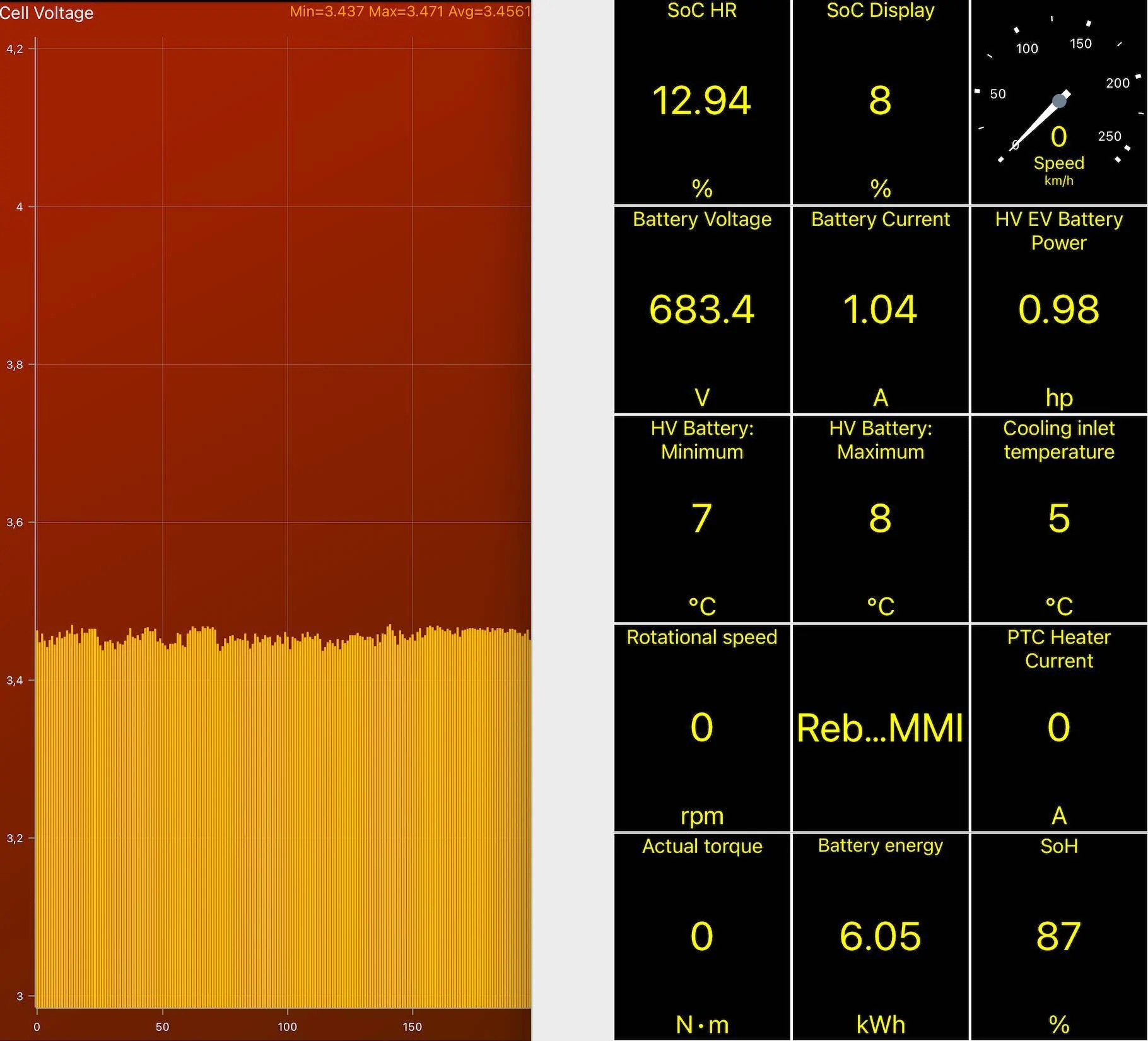

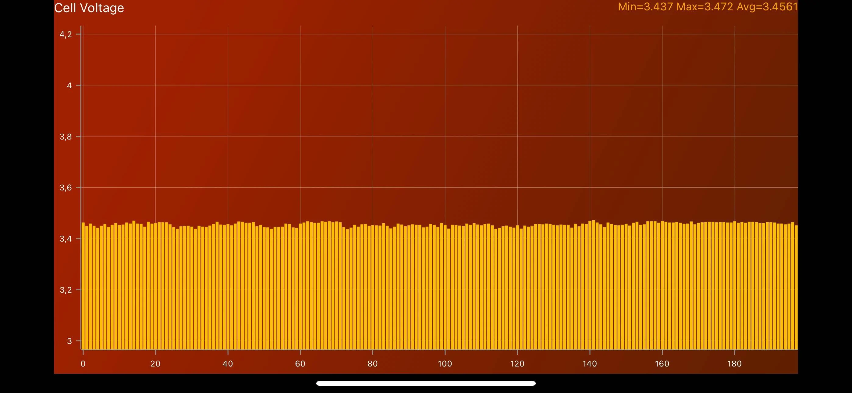

I did a reading this evening at 8% SoC and since my last reading from the summer the SoH dropped from 90% to 87% but the cell voltages look very uneven, in portrait mode looks even worst, haha.
I'll let it sit until morning and put it to charge to 100% and check how things change.
