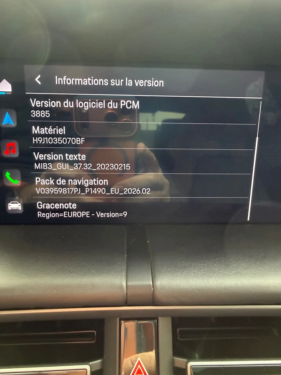

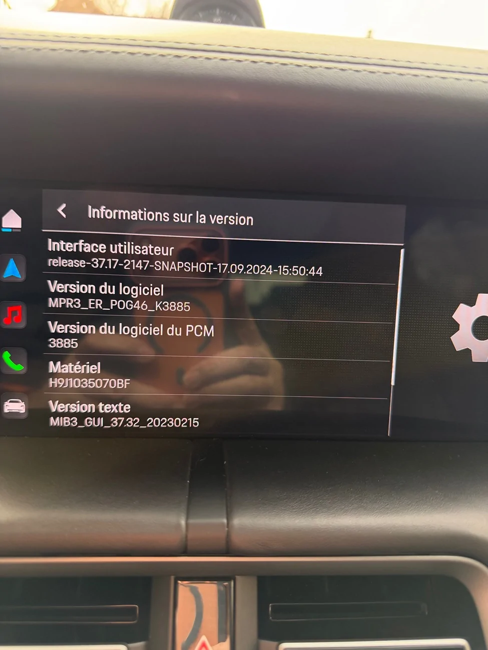

I had 3885 via OTA back in Jan and didn't notice any differences or any crashes of the PCM itself, but regardless, I stopped using the built-in satnav and PIRM about 1.5 years ago. There is nothing intelligent about the service; it quite often brought me issues.

Had 3885 couple of weeks ago, hasn’t crashed since in normal use with planner on, didn’t expect that!
Mine crashed once quite quickly.... Then nothing for a couple of weeks... Then crashed every 5mins and currently (as of yesterday) doesn't want to work at all for nav (maps show fine, calculates a route, then doesn't show it).

As mentioned previously, had 3885 update and hasn’t crashed since, but I did notice some services like the weather widget and Apple Music and podcasts went offline occasionally and I’m pretty sure this didn’t used to happen. Now it’s all gone, the LTE symbol is crossed out and I have no service.
Doesn’t make sense than this would be connected to 3885 but could it be? The car also had the 12v battery sensor update, again could losing LTE have been caused by that?
